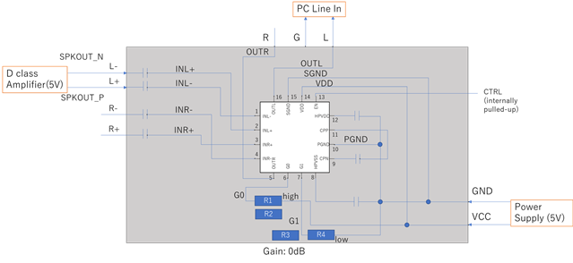

  • Sorry, here you are.
  • thanks for the schematic.

    Here is the full schematic.

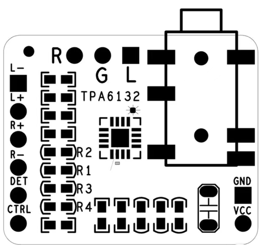

  • And sorry again for my lack of knowledge, but since I purchased the board from the market, I'm not very familiar with its usage.
    I just discovered today that EN is not set to high (on the board, EN is defined as ctrl).
    Here is the schematic of that board.

    The image you have provided is a layout and not a schematic. The schematic used to create this layout is what I need. Please provide answers to the questions asked about VDD and more info on the input signal going into TPA6132A2. Below is an example of a schematic of this device in use on its EVM:
    Ore.

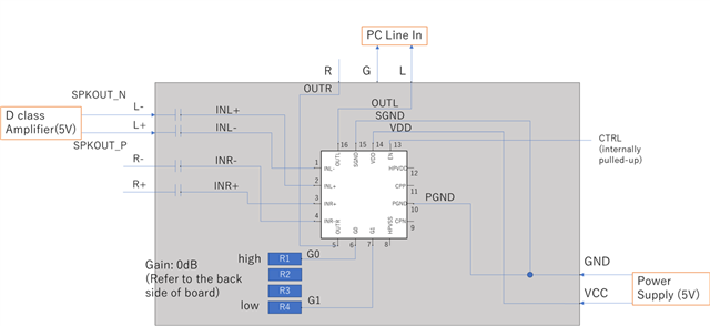

  • I'm very sorry that I don't have the schematic diagram for this board, as I purchased it on Amazon and currently I cannot contact the seller.
    I used a tester to check the connections on the board and, based on that, I did my best to draw a schematic diagram, which I hope can serve as a reference for you.
    Additionally, the VDD of the TPA6132A2 is 5V, and the Vpk-pk of the PWM input signal going into the TPA6132 is also 5V.
    And, about the EN pin,  I confirmed using an oscilloscope that it is pulled up internally in this board, so it does not affect the operation of the TPA6132A2.
    Thank you!

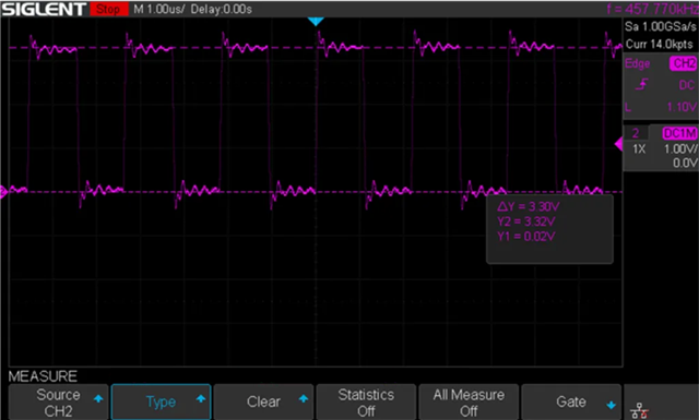

    Thanks for this. While I review this schematic and your current setup, please provide a scope capture of the output signal clipping and the input signal going into the device.

  • Hey Ronghui,
    Here is my comment after reviewing the schematic:
    • The charge pump circuitry is missing. CPP and CPN need to be shorted through a 1uF cap. An example can be found in the TI EVM schematic attached to this thread. Below is the info on the charge pump:
    • TI is not responsible for the EVMs non-TI vendors create using a TI part. Based off the DS, the gain can be controlled using G0 and G1 and different combinations generate different gain levels. Attached is the table describing how to determine gain:
                The voltage limits on those pins is also stated in the DS:
    • The schematic is missing HPVDD and HPVSS connections that also support the charge pump circuitry. Below are guidelines as to how those pins should be connected.
    Ore.
  • Here are the captures of input signal and output signal.
    Please refer them to check, thank you.
    input signal
    Input signal
    Output signal
  • Sorry, I didn't have time enough to check all the pins yesterday. Today, I confirmed these pins according to your instructions and found that their connections are fine and consistent with the information you provided.
    However, I'm not quite sure about the capacitance values used between them.
    I have updated the circuit diagram; please confirm it. Thank you!

  • Hey Ronghui,
    Now that I have all this information, I see you are lacking the proper circuitry to allow TPA6132A2 process an analog input signal. Your application is a monitoring application. I suggest passing the PWM signal through a LPF filter to monitor the signal as an analog signal.
    Your top level system would need a LPF on the PWM signal entering and leaving the TPA6132A2 device. I attached an example below:
    Ore.
