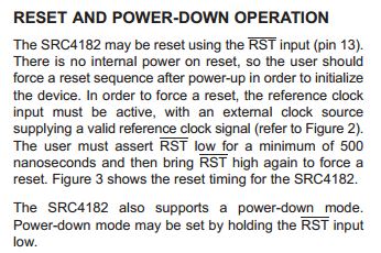

    Do they do a reset at start-up? I wonder if this is causing the problem?
    What happens if they unplug the source after the device has been playing audio? It looks from your one plot that there is not a problem then, so I'm suspecting the start-up reset?
    From the d/s:
    -d2

  • Hi, Sonoki,
    Unfortunately, the device requires clocks in order to start-up properly. This is what is causing the issue - the part is in an unknown state until the clocks are supplied.
    So, they somehow need to figure out how to keep the part in RESET until valid clocks are available. In our designs, we usually use something like the SPDIF lock signal from the DIR9001 to accomplish this, for example.
    -d2
