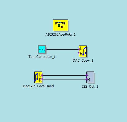

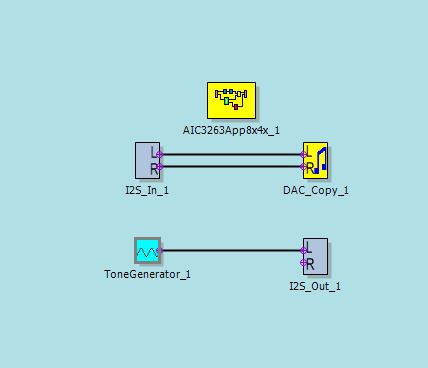

Do you have PurePath Studio installed? If you use the tone generator component on the miniDSP_A side connected to DOUT component, it will help narrow down where the problem is.
J-
J,
I do have PurePath installed. Sending a tone to the I2S output I record only the tone on the PC. I'm sending audio to I2S in with media player which I can hear through the handset. In this configuration I record only the tone.
If a tone is sent into the DAC and record as shown below I get both the tone and my voice on the recorded audio.
In simplest terms this was my configuration. Mic data in to the digital out and digital in from the pc to the handset. If you record the audio on the PC end you get both the music plus the voice data.
