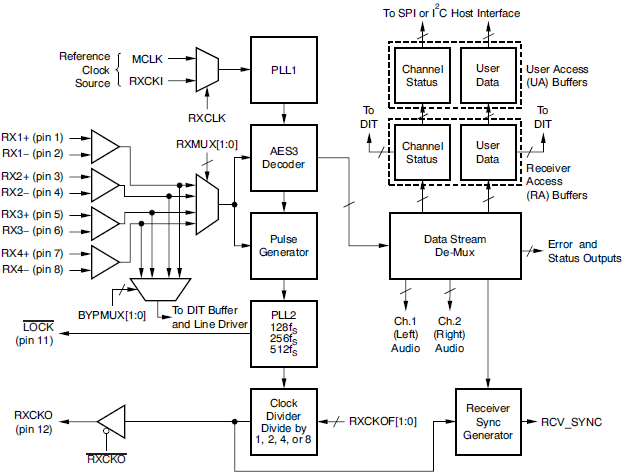

Can DIT Line Driver of SRC4392 output 384kHz sample data by the bypass multiplexer setting?

    Unfortunately, the SRC4392 is limited to input/output sampling frequencies up to 216KHz. So, your application cannot be made.

    If LDMUX bit of Transmitter Control Register 2 is set as Bypass Multiplexer Output, Is an input S/PDIF signal only bypassed to DIT buffer without decoding in DIR?
    In this time, can SRC4392 DIT Line Buffer output the 384k S/PDIF signal?

    Even if a SRC4392 is able to bypass a 384 kHz SPDIF signal, we do not test this and cannot guarantee its operation across all parts.
