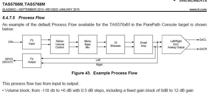

Next, the datasheet offers the following information about the volume control:
This invites all kinds of confusion.
1.) SLAA653A describes the bottom range of the volume control as -103dB (value of 0xFE).  The datasheet, above, shows it going down to -110dB.  Which is correct?  Perhaps -110dB is referring to the amount of attenuation in mute?
2.) SLAA653A describes the top range of the volume control as 0.0dB (value of 0x30), but the datasheet above shows it going to +6dB.  If that is true, how do I get that extra 6dB?  Set the register value to 0x3C?  The register map in PPC3 implies that it is acceptable to set the volume to something higher than 0x30 because the top two bits aren't greyed out, which seems to be the convention for indicating that bits are illegal:
3.) The "fixed gain block" needs clarification.  The "fixed" wording implies it can be set to either 0dB or 12dB of gain.  Is this correct?  If not, what is the step size?  What register controls it?  Is the gain block in the digital or analog domain?  I'd guess the latter, because if it's digital, then it seems like it would simply be part of the main volume control rather than an additional, independent digital volume control.
4.) Does the "fixed gain block of 0dB to 12dB" operate independently of any other volume control mechanism?  That is, if I set everything to its max value, the info above suggests that my max volume would be +18dB.  Is this correct?
