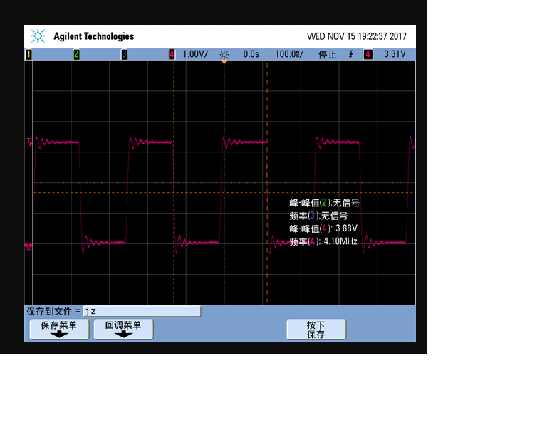

                                                                                    figure 1
The figure 2 is the VOUT_x- waveform and the DINx waveform. There is no input signal in this case. The red wave is  VOUT_x- waveform.
The blue line is  DINx waveform.
                                                                                   figure 2

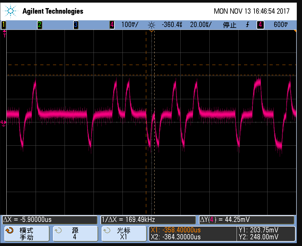

Case 2: If the customer changes the SCKI frequency from 4.096M to 8.192M ( increase by one time), the OUT_X waveform will change
from 85kHz to 169kHz. Please check the figure 3.
                                                                                                    figure 3

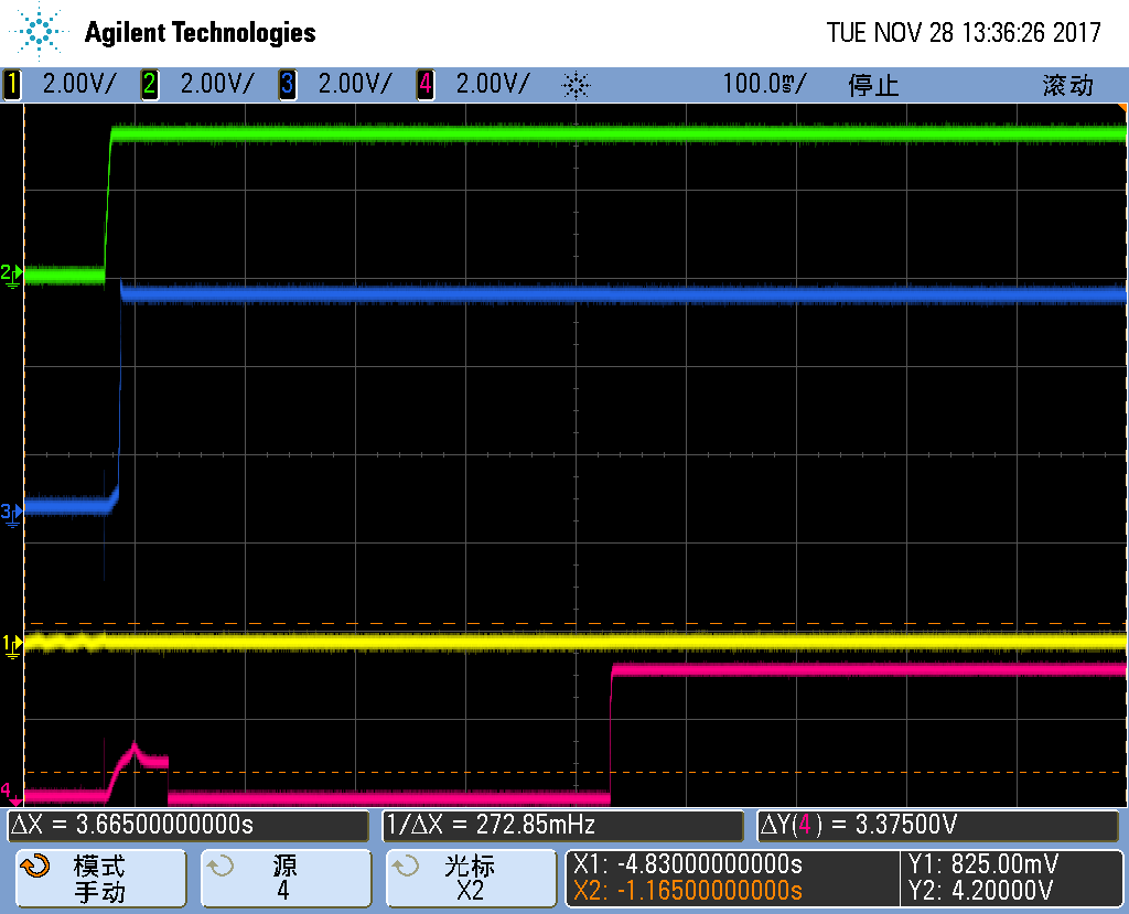

    1)  Figure 1 is the power sequence of  the PCM3168A, The green line is  +3.3V power supply, the blue line is +5V power supply, the  yellow line is OVF pin's waveform and the red line is RST pin's waveform. I monitor the OVF pin because the datasheet describe that “The OVF pin also indicates internal reset completion by transmitting a 4096 SCKI width pulse” . According to illustration 1, RST pin is keeping  in LOW state for above 350ms after all the power supplies were stable. But I can't detect a 4096 SCKI width pulse from the OVF pin. I'm not sure is that a problem?

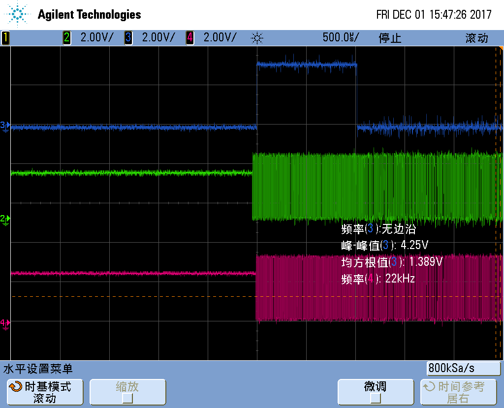

    After configuration had been done,I rechecked the DOUTx and found out the clutter had transformed, and its waveform show in figure 2. The green line is DINx‘s waveform(there is no data), the blue line is DOUTx‘s waveform, the  red line is VOUT_x-‘s waveform (VOUT_x+‘s waveform is just the same but phase opposited)
     re
    Figure2

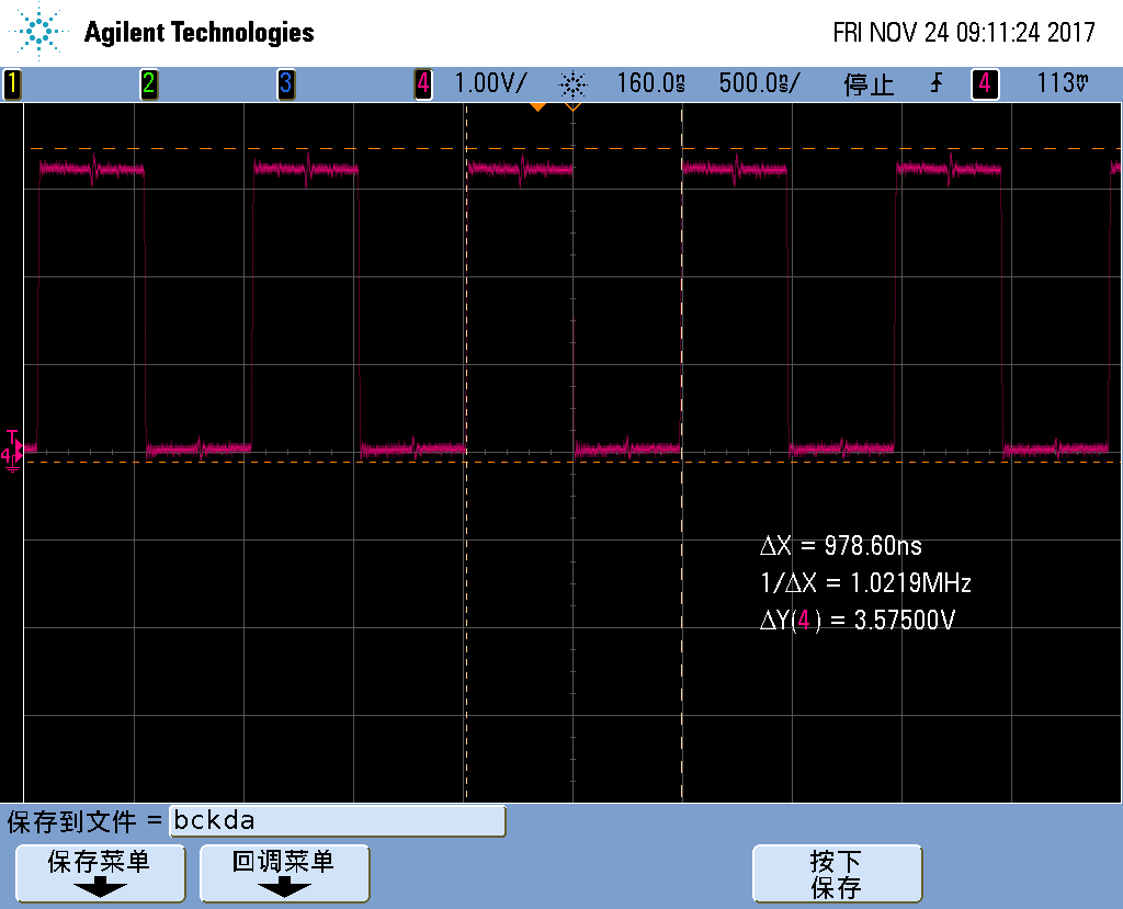

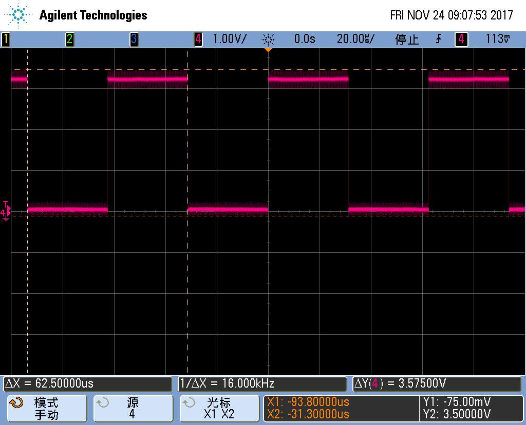

    3) Because the external oscillator is 4.096 MHz,so the sampling rate(LRCKAD/DA) is 16kHz, its waveform shows in figure 3, and bit clock (BCKAD/DA)is 1.024MHz, its waveform shows in figure 4

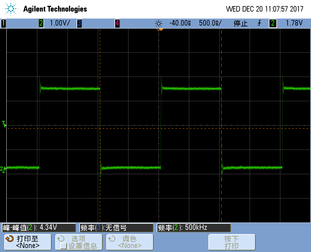

  • Hi, Diego Melendez,

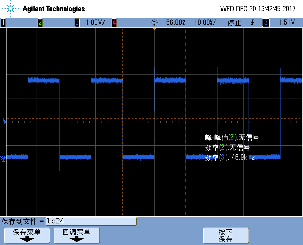

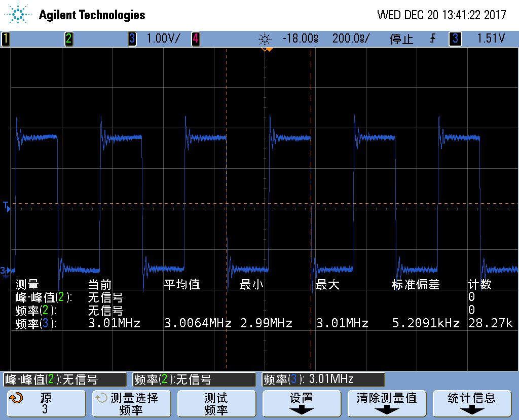

             I have reworked my board for using the device in slave mode. Clock signal was provided by OMAPL138, and we have tried two different frequency(4MHz, 24MHz), but the issue still occurred while there was no data input.

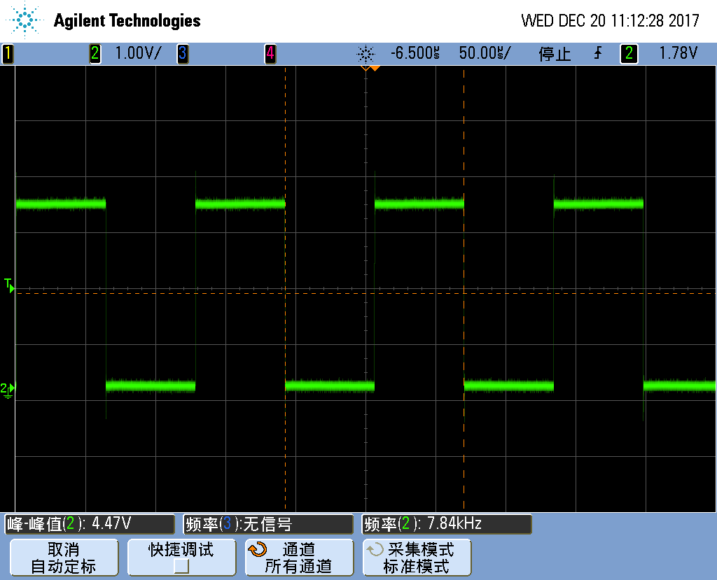

             1. OMAPL138 was initialized to provide a 4MHz Clock to PCM3168A’s SCKI pin, sampling frequency fs = SCKI/512 = 7.8125KHz. The waveforms of SCKI, LRCKDA, BCKDA and VOUTx± are shown as follows:
    Figure 1 SCKI (SCKI = 4MHz)
    Figure 2 LRCKDA (SCKI = 4MHz)
    Figure 3 BCKDA (SCKI = 4MHz)
    Figure 4 VOUTx± (SCKI = 4MHz)
    2. OMAPL138 was initialized to provide a 24MHz Clock to PCM3168A’s SCKI pin, sampling frequency fs = SCKI/512 = 46.875KHz. The waveforms of SCKI, LRCKDA, BCKDA and VOUTx± are shown as follows:
    Figure 5 SCKI (SCKI = 24MHz)
    Figure 6 LRCKDA (SCKI = 24MHz)
    Figure 7 BCKDA (SCKI = 24MHz)
    Figure 8 VOUTx± (SCKI = 24MHz)
    Although the amplitude of the clutter become smaller when SCKI = 24MHz, I think it is still abnormal.
