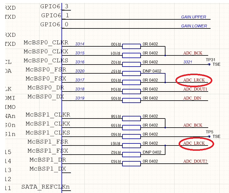

We have completed the schematic for PCM3168A in our system based on the discussion (link given below) in another thread. We are configuring PCM3168A in hardware mode.
e2e.ti.com/.../DSP_5F00_PCM3168A_5F00_Schematic.pdf:1230:0]
We need the schematic review for this.
Please have a look on attached schematics.

Hi, Muhammad,
In general the schematic seems fine, please refer to below comments:
-Diego Meléndez López
Audio Applications Engineer
Hi, Muhammad,
The correction seems fine. I just noticed another thing, it seems you are not populating the corresponding resistor to transmitter and receiver for the LRCK clocks on the slave/master interfaces respectively, which seems fine. This approach should be taken as well for bit clock.
