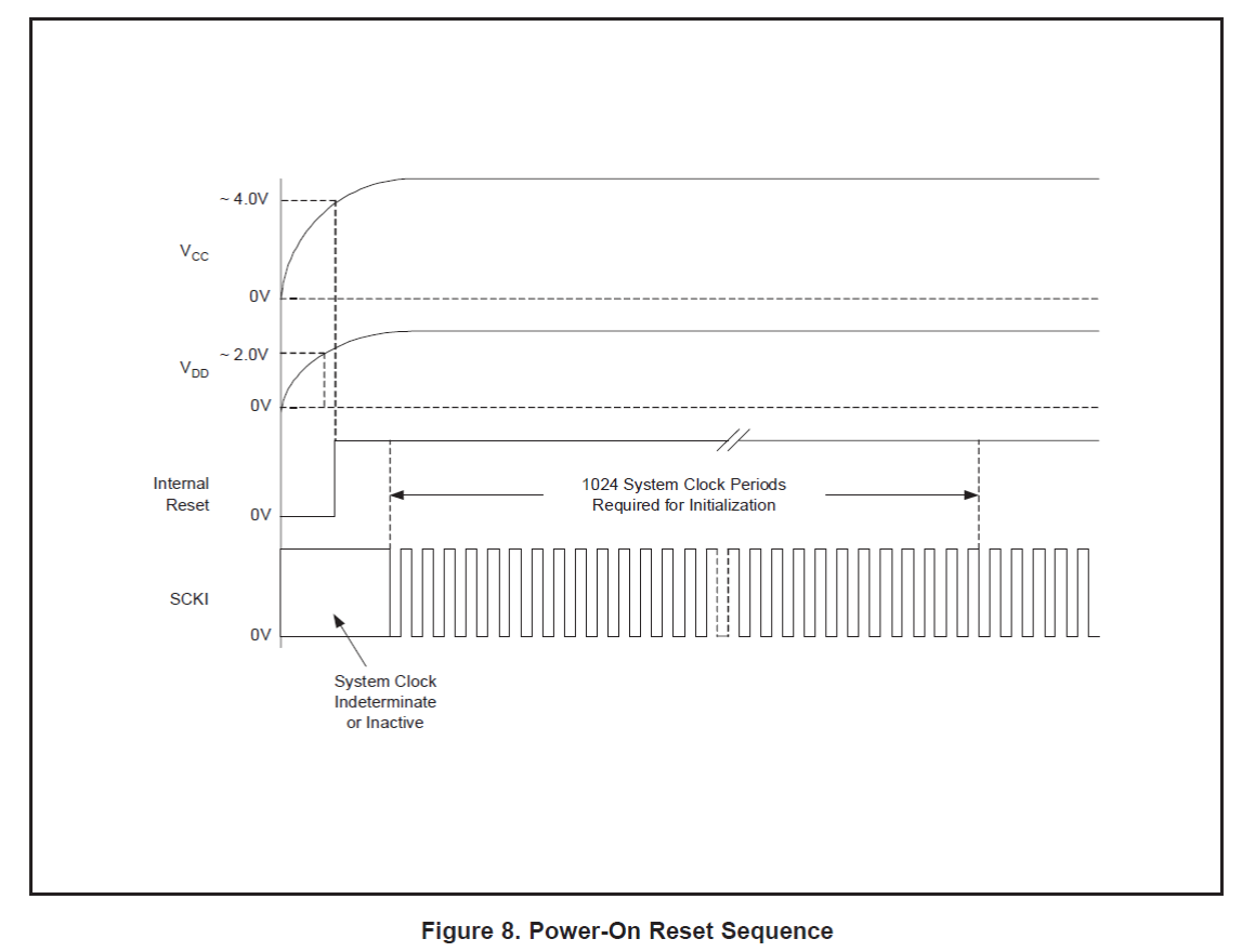

During the power off the Vcc +5VA drops to 0V but my VDD +3.3VD doesn’t drop to zero. Instead, it drops to 2.1V.
According to data sheet:
The power-on reset circuit
monitors the VDD (pin 14) and VCC (pin 22) power supplies.
When the VDD supply exceeds +2.0V (±400mV) and the
VCC supply exceeds +4.0V (±400mV), the internal reset
signal is forced high. The PCM4202 then waits for the
system clock input (SCKI) to become active.
Q1: Can I get proper Power-On Reset after power on, i.e. Vcc goes from 0V to +5V and VDD goes from 2.1V to 3.3V? Do you think my issue is reset related? Why doesn’t happen all the time? Why doesn’t always impact all A/D when the excessive noise occurs?

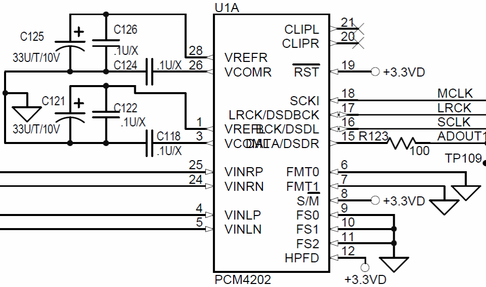

Q2: My schematic is attached below. RST(pin19) has internal pull-up). Do I must to have pull-up for HPFD and S/M (PCM4202 is in Slave mode on our board)?

    For power on reset, see below scopeshots:
    The above scopeshot shows the +5VA Vcc (red color) and +3.3VD (blue color) supplied to PCM4202 starting 350ms earlier before digital clocks start.
    The above image png shows the first LRCK, MCLK(i.e. 12.5MHz SCKI) and BCLK (3.125MHz BCK).
    The above scopeshot shows the PCM4202 DATA is not ready until 22.859ms after System Clock SCKI becomes active. Based on data sheet, the DATA should be valid after the 1024 SCKI clocks initialization period. Why PCM4202 doesn’t behave as specified in the data sheet?
