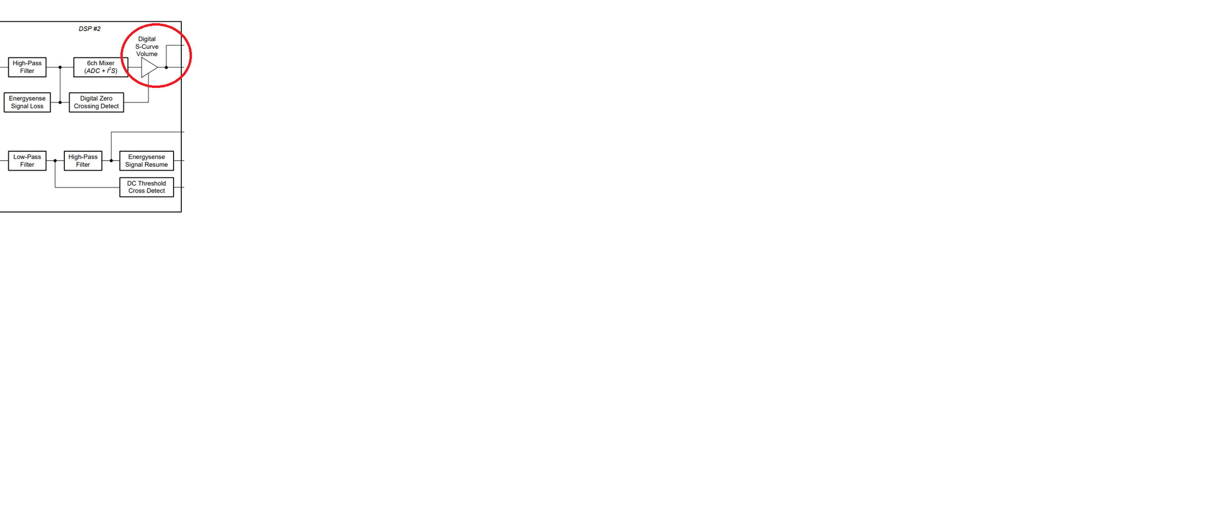

In the internal diagram of PCM1863, there is one S-curve volume block in DSP #2. But there is no detailed description in datasheet,  how to change this volume?

    The S-curve block is a fixed function in the DSP and controls the volume during fade-in and fade-out to avoid pop noise on startup or when muting/unmuting. This is not something you can configure, but an automatic behavior of the device.
    Volume adjustment is provided by the analog PGA, Digital PGA, and the mixer coefficient settings.
