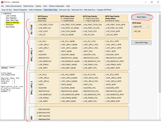

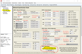

My customer is struggling as un-lock phenomenon.
Please kindly checkout attached files?

Condition:
XO_P/N
48.0000MHz/X202  it is OK as un-use case.
TCXO_IN
10.0000MHz/X203 it is OK as un-use case.
IN074.25/1.001MHz
OUT0/1/2/3
161.1328125MHz(Fixed freq)
OUT4/5/6/7148.5/1.001MHzIN0 x2、lock with IN0
My Customer add PLL calibration command after register update which is generated by TICS Pro.

  • Hello Hironori-san,
    I'm struggling to understand what is the actual question..? Or what is unlocked...?
    Is the questions is an XO required for this operation? Then the answer is yes. The APLL requires an XO to be connected and the configuration to be generated using correct XO frequency value, otherwise device will not function.
    With regards to TCXO, it is only required in 3 loop mode. Based off of your image, I can see for step 5 only 2 loop mode operation was selected, so TCXO is irrelevant here.
    Was a runscript done? When I use the same inputs you have provided in the image, I can slightly different DPLL lbw (DPLL2 lbw 9.994 vs yours that is 10.03 - a bit curious since these are very exact numbers unlikely DPLL1 and DPLL2 match exactly, which your image shows it does), which suggests either different starting point or yours hasn't updated to your new settings, meaning a runscript wasn't run.
    Post runscript, a simple software reset is recommended. This is R12, although I don't see any issues with doing a PLL soft reset either.
    If the above information is not helpful, please let me know exactly what is failing or what the issue is. A status readback is always recommended in order to debug the issue with device.
    Thanks and regards,
    Amin

    What is the status readback show? Is the DPLL locked or not?
    If the DPLL is locked, the output should not be moving vs the reference as there's still an integer relationship between the 2. The fact that it's moving would indicate to me some frequency error (+/- ppm) meaning DPLL isn't locked.
    Another test to try, if the reference is shifted by x ppm, does the output shift by x ppm as well?
    Amin

  • Hello Kazuhiro-san,
    Why are so many registers skipped?
    The register information of interest should be in the regmap but you can also find it by hovering over the field in TICSpro and seeing the register info in the context note section.
    R14 and R15 are DPLL status registers. Seems like both 0x000e and 0x000f are reading back 0x00 - meaning none of the DPLL bits are flagged.
    R742[4:7] shows REF valid state. 0x02e6 readback shows 0x40 which means only IN2 is valid. This doesn't make sense as it is not even a "used" option on your front page - it's left as "unused". Was this a readback?
    R767 [0:5] and R771 [0:5] will tell us about DPLL reference select, which reference the DPLL has selected. 0x02FF is reading 0x01 which corresponds to REF0 correctly. 0x0303 is missing.
    Since the reference valid is not being shown correctly I'm still uncertain to exactly say what state is the device in.
    Was a runscript main start page when the entries were put in each section.
    Amin
  • Hello Amin-san,
    When I click "Read Status Regs" tab , I readback the register of the yellow circle.
    Readback again
    0x000e 0x00
    0x000f 0x00
    0x02e6 0x10
    0x0303 0x01
    Please teach me the address that  to can determine what state is the device in.
    Excuse me
    Would you please instruct me on specific operations?
    Kazuhiro Nishimura (Panasonic)

    So this reset condition is completely new - where is that coming from? Or what is telling you guys the EVM is in reset condition? The power consumption should be close to ~800 mA for most blocks active type of configuration. If device is in reset it will read something significantly lower, somewhere between ~50 - 150 mA.
    Second thing, status registers are read registers. They're are meant to be read and it will let you know what condition the device is in and what needs to debug. Programming status registers is pointless. Btw, all this should be in the EVM user's guide.
    Rather than sharing raw register readback, why not look at the status tab? That will convert the register data to meaningful input rather than trying to convert hex data and looking at the bit:
    Note below that will be DPLL REFSEL STAT readback as well - this will tell us what reference the DPLL has selected.
    The data that was shared, implied the REF2 is valid while the main start page shows IN2 as unused - so there's something wrong here. This cannot happen. Was a runscript performed after the inputs were put in to the main start tab:
    No runscript - no configuration has actually been generated.

  • Hello Amin-san,
    This model is OK, but the problem of another model has not been solved.
    IN3: 148351648.351648MHz OUT4: 148351648.351648MHz
    I want to get OUT4 with IN3 phase-locked
    OUT4, which is phase-locked to IN3, is not locked. The flow of the oscilloscope has not stopped.
    I will set here.

  • Hi Kazuhiro-san,
    Email communication mentioned issue is resolved? Was that only covering initial issue and this is now second issue?
    Again, best way to understand what's happening is to review status feedback on the status tab:
    • Is REF3 valid?
    • Is DPLL2 selecting REF3?
    • Is DPLL2 locked?
    Also, from your original config you will have to change selection in step 2, to make sure DPLL2 can select IN3:
    And press the runscript button again. This will recalculate DPLL and reference settings.
    With regards to PPM what you have highlighted is correct, that is the setting for how much DPLL tracks with reference and at what point does it no longer track and switch to holdover mode (which you keep frequency lock, long term lock determined by XO stability or TCXO stability in 3 loop mode).
    Amin
