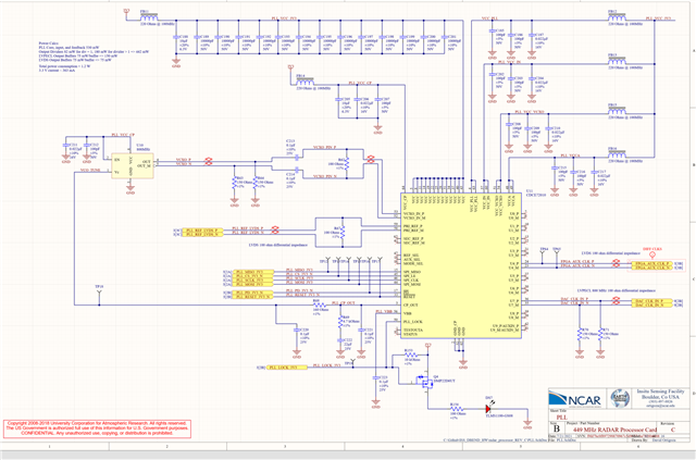

Our customer would like to know the proper CDCE72010 PLL configuration, please see the query as follows:
I am using a CDCE72010 PLL, and it runs very very hot on my board. I found a similar post on the forum where if you use the PLL with certain settings or in a certain configuration, it will run very hot.
This heat is causing performance issues on my board with the clocks being generated by the PLL, so I wanted to post the settings that I am using, and which clocks I need to generate, and see if there was a more efficient setup I could use.

I am using an 800MHz crystal on the PLL and only need to generate 800 Mhz on channel 7 and 200 on channel 4. The input clock is 20M on the primary input
Your assistance is appreciated.
Carlo

  • I am referring to this post:
    https://e2e.ti.com/support/clock-timing-group/clock-and-timing/f/clock-timing-forum/617165/cdce72010-cdce72010-on-ads5562evm---overheating-currently-running-with-200mhz-xo
    There was another post that seems to be missing now where the Applications engineer asked to see the device configuration....
    I cannot measure current on the device as it is soldered down to my board in a working circuit, but I can assure you this thing is running too hot. It runs hotter than my FPGA and all it is doing is making 2 clocks.
    Could you please look over my configuration and divider setup to see where I can reduce power on this?
  • Hi David,
    We are not sure on the register settings, which may responsible for heating the device. But we can help to debug the issue.
    Can you please provide the details on below:
    1. Are you seeing the device temp rise for other same boards also?
    2. Before programming, is there any temp change on the board?
    3. Is the PLL lock after programming (Lock detect status)?
    4. At a first glance, your configurations looks good but see some deviations from your text above. Please clarify the same:
    i) There are 4 output clocks from channel 2, 4, 6 and 7 with /10, /2, /32 and /1 divider configuration respectively.
    ii) Why the R0 [3] is not writing?
    iii) Register settings not mentioned for the reserved bits detail, those should be set to '0'. Are those bits writing '0'?
    iv) Is the readback working on your board? please verify the writing and readback data are same.
    Ajeet Pal
  • 1) I am seeing the temp in the range of 70C for all boards
    2) Before programming the part is cooler. I suspect it is inefficient counter values that run this part hotter. I have adjusted some settings to reduce counter values and have run a faster reference clock into the part and it runs 10 C cooler....
    2a. Adjusting the counter values to cool the part made my 800MHz waveform worse affecting the DAC that uses this clock down stream worse. (Dac output waveform has 800 MHz jitter of 1.25ns) This is the crux of the problem. I want to make this clock as clean as possible. If we can find suitable settings that reduce this generated clock's jitter to a minimum I would like to try that first
    3) The PLL locks easily after programming. Putting a scope probe on this indicates that the PLL stays in lock. Adjusting some of the counter values had a negative effect on the PLL lock and the PLL was having a harder time locking with some settings.
    4) i) Even though I have divider settings on those other clocks, I have the output set to off. Wouldnt that save power in this case? I have since turned off those dividers as well.
    ii) Strange. I will uncomment that.
    iii) What is the reverse bits register?
    iv) readback does work as the FPGA code polls digital lock status after config.
    Some detail on 2a) I am using a DAC3283 on my board that requires the 800 MHz LVPECL core clock. When looking at the clock from the CDCE PLL on an oscilloscope I cannot tell any difference in settings in degredation in either voltage level or Jitter performance, HOWEVER the DAC generating a waveform downstream has about a 1/1000 jitter of 1.25ns, telling me something is wrong with this 800MHz clock. Playing with the counter settings and adjustiting the reference clock going into the CDCE PLL can make this WORSE.
    I am looking for optimal settings for this waveform and such that the CDCE PLL will not be affected by temperature variation. If I blow air on the PLL circuit I can exasperate this issue further. If I cool the PLL with a heatsink and constant steady-state air cooling I can get the jitter to happen less frequently (about 1/10000 cycles)
    Part number for the VXO: ECXV-P37C2M-800.000
    Filter values according to figure 34 of the datasheet:
    C1 - 0.1uF
    R2 and C2 - 4.7K and 22uF
    R3 - 160ohm
    C3 - 0.1uF
  • Hi David,
    In your settings, you are using feedback divider with its full range (80) and as you mentioned above, while reducing the counter, temperature got down by 10 C. Are you reducing the feedback divider or N divider?
    I would be suggesting to try reducing the feedback divider to lower value and increase the N -divider for feedback section with the fixed M-divider (20) and see the performance.
    Higher phase detector frequency helps to improve the jitter performance. Hence you can try with increase the phase detector frequency.

  • Hello Ajeet,
    Here is the response I received from our customer:
    The register settings you have provided do not help with the 800MHz clock jitter. With these settings, the PLL runs at 74C instead of 79-80C. This is still far too high if I am only producing one clock and all other clocks are disabled.
    I uploaded your registers as is and did not modify them.
    Attached is the schematic sheet for the PLL.
    According to this excel sheet which is provided with the CDCE PLL evaluation board, I should have plenty of stability in phase and gain margin. What are some target points I should be shooting for?
    CDCE72010_PLL_Calc_REVC.xls
    Carlo
  • Hi Carlo,
    Please allow some time to go through the schematic and will update you soon.
    Ajeet Pal
  • Hello Ajeet,
    Do we have an update on this?
    Carlo
  • Hi Carlo,
    Sorry for the delayed response.
    I don't see any issue in the schematic, it looks pretty well. Even from the programming wise it looks good with customer's setting as well as what I had provided.
    I would think of do few iterations on the board for debug. Please verify on the board:
    1. Schematic doesn't show the AC coupling caps at the DAC side and I assume it should be there. If not, then isolate the DAC clock and see the Temp variation.
    2. Turned OFF the both required output buffers one by one and both then observe the temp.
    3. Try to reduce the phase detector frequency by increasing the divider counters and tune the loop filter BW.
    Ajeet Pal
  • Hi Carlo,
    I would also be suggested to verify the thermal pads layout of the device to follow the layout recommendation mentioned in datasheet.
    If it doesn't follow the recommendation, that also may affect the heating performance.
    Ajeet Pal
