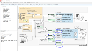

    We are using LMK04832 and LMX2820 in our design for ADC and DAC sampling clock generations. our clock architecture is as shown below.
    LMK input:
    LMK04832 default has 100MHz input to clockin1 provided from external source, 100 MHz VCXO input to OSCin and sync signal input to Clockin0. (Optional Ref clock and sync is provided to Clockin2 and SYNC/SYSREF_REQ pin).
    LMK outputs:
    DCLKOUT0 : 270MHz( input to first LMX2820)
    SDCLKOUT1: sync to first LMX2820
    DCLKOUT4: 270MHz( input to second LMX2820)
    SDCLKOUT5: sync to second LMX2820
    SDCLKOUT3: 6.75MHz AMS_SYSREF
    DCLKOUT6:  270MHz DAC_REFCLK
    SDCLKOUT7:  6.75Mhz DDR_PLY_CAP
    DCLKOUT8: 54MHz PL_CLK
    SDCLKOUT9: 6.75MHz PL_SYSREF
    DCLKOUT12: 270Mhz ADC_REFCLK
     AMS_SYSREF, PL_CLK, PL_SYSREF requires synchronization and alligned to each other.
    a. We are using LMK04832 in dual loop mode and in order to generate required output, VCO1 of PLL2 is used at 3240MHz frequency. Since datasheet specifies the max frequency of VC01 is 3255MHz, will be there any performance issue of VC01 since we are using at the upper edge of VC01?
    PFA the Ticspro file FYR.
    Please verify the Ticspro configurations for our requirements and provide the suggestions.

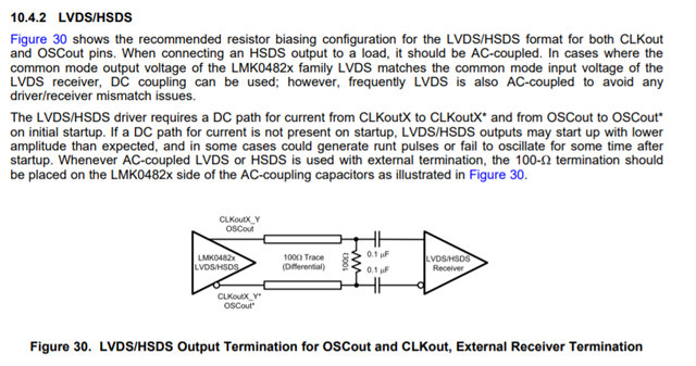

    c. Regarding clockout terminations as per LMK04828 datasheet, ( since LMK04832 and LMK042828 are pin to pin compatible, we reffered LMK04828 for output terminations), clock out signals which doesnt have internal termination at receiver, should be terminated as
    Our DDR_PLY_CAP, PL_CLOCK, PL_SYSREF doesnt have internal termination and requires 100ohm external termination usually after coupling capacitor towards the load pin, but LMK04828 datasheet recommends to use 100E termination before coupling capacitor towards LMK. which one to follow? in our design we have provied optional 100E termination after coupling capacitor which will be DNI. Can you confirm whether that can be removed? (refer pg5 of attached schematic).

  • Hi Kiran,
    Since you have single-ended SYNC, I suggest put CLKin0 as MOS input.
    We test VCO frequency coverage in production, so there is no issue even if you operate it at the min./max. frequency.
    You have a 27MHz domain system, I suggest change the VCXO to 108MHz or 135MHz so that you can maximize PLL2 fpd. With a 100MHz VCXO, the highest fpd you can use is just 20MHz, output phase noise from PLL2 is not going to be excellent.

    Figure 30 is correct. LVDS is a current source, the current flowing through the resistor will therefore create a voltage across the resistor. If the receiver is a standard LVDS receiver, then the DC-blocking capacitors are not needed. If the receiver requires AC-coupling, then Figure 30 is exactly what you need.
    Regarding VCXO frequency, As per mistral's design VCXO is 100MHz, that would reduce the  PLL1 N / R ratio R =1,  But PLL2 N / R ratio will not reduce such that R = 1. However,if the VCXO is 108MHz or 135MHz, PLL2 N / R ratio will reduce such that R = 1 but not the PLL1.

    the loop bandwidth of PLL1 is going to be very small and it does not require a high fpd. So if you use 108MHz VCXO, PLL1 fpd = 1MHz, which is same as if you are using a 100MHz VCXO. PLL2 requires higher fpd in order to reduce PLL noise and make loop bandwidth wider. if you want as low jitter as possible, the VCO frequency should be an integer multiple of VCXO frequency. As long as the phase noise is identical, there will be no performance difference between LVPECL and CMOS VCXO at this frequency. The SYNC signal is use to phase align all the clock outputs, it does not have to be very low noise.
    CLKout and OSCout will have some deterministic delay (a few nano-second) which should not post an issue considering that your SYSREF frequency is low. Otherwise, you can put the LMK device in 0-Delay Dual Loop Mode such that the clock outputs will be phase aligned with OSCout.
    As for LMX configuration, you can make fpd = 270MHz in order to get lower in-band noise.

    Is it good to use 120MHz VCXO with N prescaler of PLL2 VCO as 3 and R divider as 9 so that my PLL2 fpd will be 120MHz.
    Thanks in Advance
    Kiran
  • Hi Kiran,
    Yes, you can use the 120MHz VCXO with 3240MHz VCO frequency and PLL will lock with above shown N-prescaler and N-divider values. R-divider value can keep 1.
