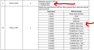

Section 8.1.3.2 and 8.4.2.1 states that OSCout can be provided before programming LMK04832-SP.  If I provide a LVDS osc to OSCin, what will be the default OSCout buffer type?
Also, In section 8.2 Functional Diagram, it indicates that it is SPI selectable. By default it is OSCin or do I need to program that?
 Also, if LMK04832-SP is powered up...what is the time from power up and the output of OSCout?

  • Hi Jiahui,
    The LMK04832-SP OSCout buffer is configured for LVPECL 1600 mVpp output format in default POR condition, irrespective of the OSCin input format.
    By default OSCout has buffered OSCin source and the output format and input source can be SPI controlled.
    We didn't specify the timing the for the OSCout after powered up but LMK04832-SP should have POR default OSCout output clock just after the device powered up.
