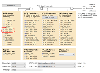

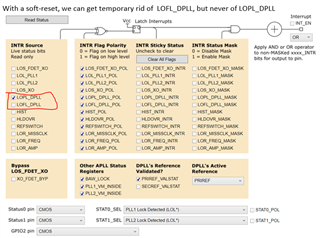

1) We're not able to get rid of two error flags of DPLL: LOFL_DPLL and  LOPL_DPLL.
When the PLL is reprogrammed while run-time, LOFL_DPLL disappears, but LOPL_DPLL is always flagged.

  • Hello Julian,
    There reason you are having issues with the DPLL locking is because your XO frequency is an integer multiple of the VCO1 frequency.
    In DPLL mode, the XO frequency must have a non-integer relationship to the VCO1 frequency so APLL1 can operate in fractional mode (required for proper DPLL operation).
    By changing your XO frequency to a non-integer multiple of the 2500 MHz frequency of VCO1, you will be able to solve the issues you are facing.

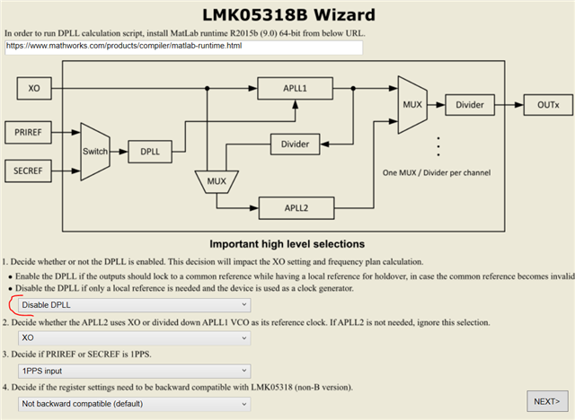

    I tried another configuration with disabled DPLL:
    Now I have a new error, flag (HLDOVR) and LOFL_DPLL and  LOPL_DPLL is always flagged.
    But I guess, I can neglect this, because I disabled the DPLL. Isn't it?
    Disabling the DPLL does not solve the issue with OUT-7. This output is still dead and can be enabled by just re-writing all registers after boot-up.
    Please give some more advise. Thanks!
  • Hello Julian,
    Yes, the HLDOVER, LOFL_DPLL, and LOPL_DPLL flags will always be high when the DPLL is not in use.

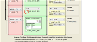

    I'm very sorry, but I mixed up OUT7 with OUT6. The issue with not running clock is on OUT6, not on OUT7!
    When I use your configuration, also OUT6 is up after boot-up, but only because your configuration do not set the SYNC-flags for this output:
    But we need to use that SYNC-Flag!
    When I use your configuration and additionally set the SYNC-Flag, OUT6 is not up after boot-up.
    Please verify on your side and give some advice. Thanks in advance!
  • Hello Julian,
    When the CHx_SYNC_EN bit is set, the SYNC_SW bit must be toggled for the synchronization to occur and for the outputs to be aligned. Once the SYNC_SW is toggled, the output will reappear. Here is an image of where the SYNC_SW control is located:
    Please load the configuration I provided you, enable the CHx_SYNC_EN bits that need to be enabled, toggle the SYNC_SW, and then save the configuration.

    Last question: We now disabled the DPLL. Does it mean that I can also kick out the CLK-inputs on PRIREF and SECREF and only use the XO-inputs?
  • Hello Julian,
    That is correct. You only need to use the XO input.
