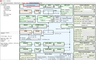

I am trying to generate 125 MHz SROUT output as well as my 2 GHz in RFOUTA (setting attached) LMX2820_SROUT125M.tcs
I got expected output in my RFOUTA but I only got DC output in my SROUT.
I follow the setting for SROUT as per the EVM user guide.
Could you kindly check what did I miss from the setting?

  • Hi Andri,
    I think I forgot to mention that the SRREQ pin needs to be HIGH. In User Controls page, check the SRREQ box. Let us know if you still cannot get a clock out from SROUT.

  • Hi Andri,
    After setting up the configuration in the PLL page, go to the User Controls page to enable SRREQ pin, then SROUT will be generated. Please try disable and then enable SRREQ pin to see if you have the SROUT clock. Meanwhile, I will ask my colleague to verify it.

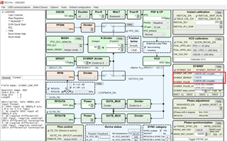

  • Hi Andri,
    Your register is showing R64=0x404184, so bit 14 is 1. Please change this bit to 0, program all the registers once and then make SRREQ pin L-->H.
    I changed R64=0x400184, the write all register, then set SRREQ from L -> H.
    But still SYSRER is DC
  • Hi Andri,
    My colleague has verified this, he could get sysref signal out with the following sequence. Would you please try again? BTW, what is the marking on the surface of the device?

  • Hi Andri,
    Your above configuration register settings are good, except change SYSREF_INP_FMT --> CMOS and R64=0x400184. With this, you should get SYSREF output.
    Otherwise, you can go ahead with the default configuration and follow the below steps:
    1. Lock the device to the desired frequency (with R64[14]=0)
    2. Make SYSREF_EN = 1 (and PHASE_SYNC_EN = 1)
    3. Make SROUT_PD = 0
    4. Make SRREQ pin = HIGH
    Thanks!
