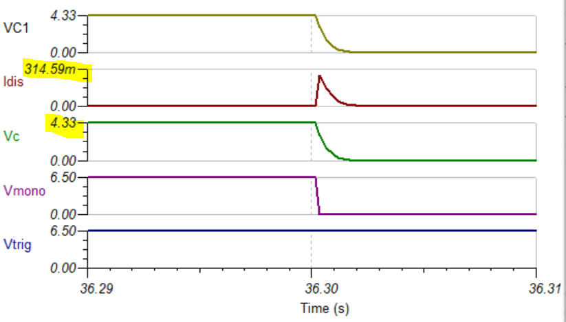

    We do not have a specification or method for calculating the max capacitor value, however we do have some results below from prior experiences and a good simulation model to help.
    The capacitor will charge up to 2/3*6.5V = 4.33V. I labeled this as Vc in the plot below. The online calculator (attached below) gives us an estimate of the discharge on resistance (ron) of roughly 13.9 ohms. This aligns with estimating from the pds curve for ron as well.
    The Tina spice model is a transistor based replica of the design and will provide the most accurate result. I see a discharge current of 314.6mA. This aligns closely with 4.33V/13.9ohm = 312mA from our estimated resistance value.

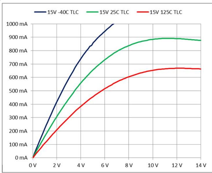

    I found a post that has a scenario that is much higher than yours. Our engineer tested with 150uF at a supply of 15V. The part functioned as expected in that scenario and the timing was consistent between tests.
    Here is the post for this scenario.
    https://e2e.ti.com/support/clock-timing-group/clock-and-timing/f/clock-timing-forum/946694/tlc555-how-to-calculate-current-flow-through-transistor-when-timing-capacitor-is-discharging
    In addition we have sample data that was provided on that post as well. Although this is at high supply it is a scenario which draws more current than your application which gives confidence.
