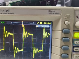

Customer input frequency is 12MHz, target output frequency is 1196kHz.
The customer has developed the following code, which is the correct code to calculate and set some of the frequencies for cdce913. However, the output target frequency of 1196kHz is set and the actual oscilloscope measures 1160kHz.

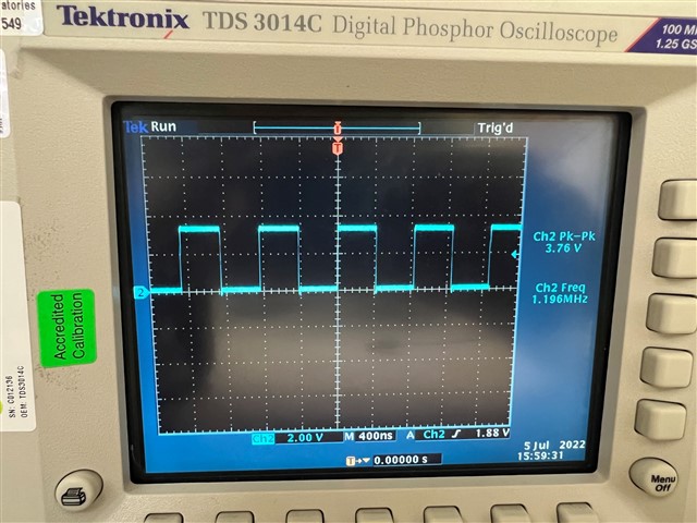

The customer places the M , N , fvco and Pdiv1 values generated by Pro-Clock software directly into the register, the software shows output 1.196 MHz, but the actual test output is around 1.156 MHz
So I wonder if this is normal?
What is the accuracy of the CDCEL913 output frequency? Or maximum deviation?
