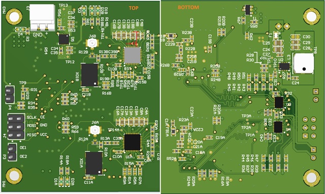

    Could you share the pcb layout?
  • Hi, thanks again for your reply.
    I am sharing a part of our PCB. We noticed some errors on the board earlier, such as routing GND to capacitors and a misplaced C23(equivalent to your C4). I marked how it was fixed, similarly in both circuits.
  • Hi Mat,
    Is it a two-layer pcb? I hope it is not as the loop filter is underneath the RF output traces, this may lead to RF signal loop back and interfering the VCO. You may try, during initial programming, make R3 = 0x2000F3F3, this will powerdown all the output buffers. If the VCO is locked, Vtune voltage will be around 1.2V.
  • Hi Noel.
    No, the PCB is 4 layers.
    With this setting(R3) you suggested and without it I have VTUNE 3.26 (almost VCC) at the input, but with other register settings it is 0.02V. The current draw in front of the ICs decreased, but I guess this is normal behavior with the output buffers off.
    I have replaced one of the circuits with another. The situation is still the same.
