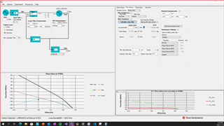

We are attempting to use a VCOCXO as the External VCXO reference for our dual loop PLL; however, we cannot get a lock with our current design.
The 10MHz VCOCXO we are using has a control voltage range of 0-5V resulting in a +/-4Hz deviation. We have designed an amplifier to take the 3.3V output of the LMK04832 to drive the 0-5V requirement of the VCOCXO.
Is there something we are missing in configuration or loop-back filter that would result in the PLL never locking?
I have attached our TICS configuration & loop-back filter simulation.
OCXO.tcs
Grant

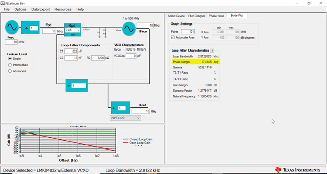

  • Hello Grant,

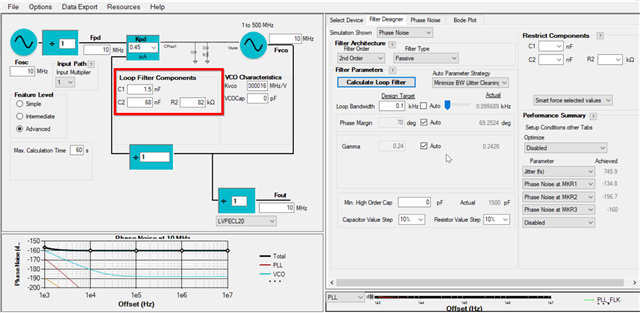

    Thank you for all that information. When you changed the PFD, did you also change your loop filter values? If you didn't, this is why your PLL is not locking. I ran the simulation in PLLatinum Sim with the new PFD and you previous loop filter topology and the phase margin is 17 degrees, which makes your loop filter unstable and unable to lock the PLL.
    Instead, I would suggest for your loop filter to have the following values:
    The loop filter is dependent on the PFD, loop filter components, charge pump, and Kvco; therefore, when you increased the PFD (and if you kept your loop filter the same) that led to lowering your phase margin and making the loop filter unstable.
    Also, if this does not work, I would suggest you look into using a DPLL instead of the LMK04832 or looking into a better performing VCXO. It will also serve as a jitter cleaner and clock generator but does not require the use of a VCXO. Based on your application, I would recommend the LMK5B33216. It has low jitter output and can generate the output frequencies you need. Still do let me know if this solution does not lock your PLL.
