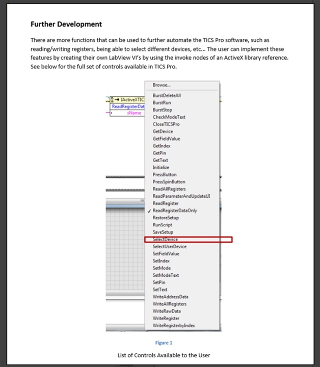

  • Hi Vicente,
    Really appreciate your efforts on verifying this.
    Besides the fact that there is no ability to read back registers of this part in TICSpro, I don't think there any register fields that indicate the PLL lock. (There is something called "PLL DLD" in LD_MUX, but I don't think that is accessible to the user?)
    If you know any register field, please let me know, I will try to read through LabView (from the previous threads, I found a library file where "Read Register" is one of them. I hope I can do the readback in labview using that lib file)
    Thank you for your support, Vicente.
    Hima
  • Please ignore the highlighted "Select Device" in the above snapshot.

  • Hello Hima,
    I looked over the documentation about our registers and it does not seem that we store that value anywhere, unfortunately (since it is an older part and we did not have that feature implemented before, as Vicente mentioned).
    However, I will let Vicente answer if he has heard something different from the designer. He is currently out of office and should get back to you by the end of this week.
