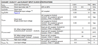

Could you please tell me what the output pin status of the LMK04828 is when it starts up, before it runs in the user program?
Background
I am considering connecting DCLKout0/0* on pins 1 and 2 of the LMK04828 to the receiver side via LVDS. At that time, the power supply voltage on the receiver side is 2.5V, which is different from the power supply for the LMK04828. We are concerned that the input rated voltage on the receiver side may be exceeded depending on the order.

  • Hello Taito,
    To directly answer your question, the default output pin status is to be enabled on the LMK04828 at start-up.
    However, to clarify based on your background statement, are you wondering if a signal inputted to the LMK04828 of 2.5-V will damage/affect the device? If that's the case, then the device will be able to handle that voltage, as shown below:
    However, make sure to provide a voltage swing with the below characteristics based on you application:
    If this does not answer your question, please provide a visual to see what's being inputted into the system.

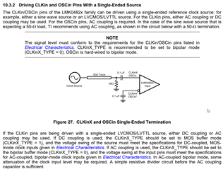

    They're considering using 43/44 pin OSCin/OSCin* with a single-ended connection to the clock. Could you please tell me the input impedance of pin 43?
    Thank you for your help.
    Taito Takemura
  • Hello Taito,
    Why do you need to know that information? I would need to reach out to the designer for it. If you are wondering how to properly how to connect those pins for single-ended operation please look at picture below (p. 104 of data sheet).
    Hope this helps!
