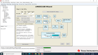

I am using LMK05318 on my board. I have 20ppm frequence deviation for DPLL Primary and Secondary Reference Clock Inputs (PRIREF_P  PRIREF_N, SECREF_P SECREF_N).
For example, in my test:
80566140 Hz input via TICS Pro software  makes LMK05318 DPLL lock.
80566406 Hz via TICS Pro software  does NOT make LMK05318 DPLL lock(LOFL_DPLL=1), even  other settings are the same.
80566140 Hz is from our real measurement on one board. 80566406 Hz is from our calculation.
What is the frequence deviation tolerance (? ppm)  for DPLL Primary and Secondary Reference Clock Inputs? Thanks!
I cannot measure every board to determine the accurate frequence for DPLL Primary and Secondary Reference Clock Inputs.
Other condition in my test :
XO: 48MHz input with 25ppm. Use LMK05318 DPLL and APLL1, not use APLL2.
Thanks!
Vaison

  • Hi, Timothy
    Thanks for your reply! I am using LMK05318 (not LMK05318B) and I am using TICS Pro software to configure a profile for the LMK05318.  In LMK05381 wizard, I saw "DPLL frequence lock detect", and  by default , it is  lock 1 ppm, unlock 10 ppm. Avg 2.   Can I change to  lock 10 ppm, unlock 20 ppm? My XO input is 48MHZ,25PPM.
    After I changed those ppm values, I did not see any recalculation button for it. Should I just press "run script" button ?
    I tried it with pressing "run script" button, the script ran and it was not able to lock with  PRI_REF and SEC_PRIREF 80566406Hz input(the expected value from our Intel chip output).
    With default  DPLL frequence lock detect lock 1 ppm, unlock 10 ppm, if  I input PRI_REF and SEC_PRIREF with 80566140Hz, the DPLL was able to lock.
    Any idea? Thanks!
    Vaison

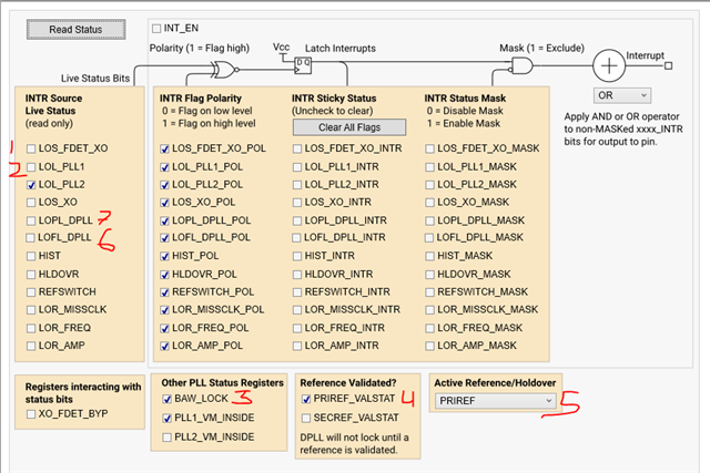

  • Hi Vaison,
    The DPLL frequency lock detect shouldn't be the issue.  DPLL freq lock detect is comparing DPLL OUTPUT with REF INPUT.  The DPLL will lock the OUTPUT to be 0 ppm to the INPUT.
     - When you type a new number and press enter, the calculation is updated.
    What I wanted to clarify is if the DPLL is even trying to lock.  In the DPLL lock procedure.
    1) Reference input must be validated.
    2) Then the DPLL will start to lock.
    Status page will show the situation.
    On the Startpage, whatever detectors are enabled must pass for DPLL to select reference.  Here, the input reference must be within 20 ppm of the XO.  So if the XO is +/- 50 ppm.  You may not even allow DPLL to lock to 0 ppm signal if XO = +50 ppm for instance.
    Also, for confirming lock of APLL to XO, you may enable the BAW_LOCK detector... (on startpage)
    Here on status page, after doing a readback...
    1) XO should be valid, LOS_FDET_XO = 0.
    2) LOL_PLL1 should be 0.
    3) If BAW_LOCK is enabled, BAW_LOCK=1.  Meaning APLL is locked to XO.  (Note bad DPLL config can force APLL to rail and therefore BAW_LOCK could be 0 due to improper DPLL config -- remove/disable references/DPLL to debug this case)
    4) The reference you want to lock to should be validated.  This refers to the validations above all being met.
    5) The DPLL will select a valid reference based on it's configuration options.
    6) LOFL_DPLL = 0.  Freq lock on DPLL.  This typically happens pretty quick.
    7) LOPL_DPLL = 0.  Phase lock on DPLL goes low, depending on loop bandwidth this can take a while.
    To better debug your problem, please go through the list of what's going on so we can identify where the problem is occurring.  For instance, is it not locking because shifting the reference frequency is causing the reference to become invalidated and then the DPLL is no longer in lock.
    Perhaps you could share the .tcs file you are using in your config?
    73,
    Timothy
  • Hi, Timothy
    Thanks for your detailed information. I did further debug according to your suggestions.
    BAW_LOCK was disable on my setting.
    I changed frequence detect threshold PREREF to 20ppm (enable) or even 1ppm (enable), the result below is not changed.
    80566140 Hz
    Lock
    80566240 Hz
    Lock
    80566406 HZ
    Not lock
    My target is to make 80566406 HZ to be locked in DPLL of LMK05318..
    My XO 48MHz input to LMK05318: 48MHZ,25PPM.
    Do you mean lmk5318 require 48MHZ+/-20PPM=960HZ for pri reference(PRIRFF) input range. From my result, it is not true.
    Can you help? Thanks!
    Vaison

    The LMK05318 TICS Pro doesn't show DPLL calculation, I would recommend to use LMK05318TICS Pro so that you can see DPLL calculation is updated when changing PRIREF.
    On the wizard page, make sure to set "Backward Compatible" so it can work with the non-B device.
    When loading your non-working config file, the DPLL shows 0 for both numerator and denominator; thus, calculates incorrect BAW VCO frequency. The correct num/den below would properly update the BAW VCO to 2500 MHz.
    This is the .tcs file with updated calculation for 80566406 Hz: 80566406Hz_updated_DPLL_calculation.tcs
    -Riley
  • Hi, Riley,
    Thanks for your update and reply.
    1.I updated TICS Pro to v 1.7.5.7 which can support  LMK05318B. I chose "Backward Compatible" at the beginning. I input all my requirement , and ran, but DPLL was not locked yet. Please see "80566406Hz using new TICS PRO backward compatible.tcs" below. Would you check? Thanks!
    2. On the other debug, I also loaded your  80566406Hz_updated_DPLL_calculation.tcs, and then clicked ''write all registers", and then read status, the DPLL was not locked yet.
    3. Do I have to use LMK05318B to fix the issue? If yes, can I apply one LMK05318B  example from your TI sales team (if yes, can you tell me his/her e-mail address)?
    Thanks for your help!

    The recommendation to use TICS PRO of LMK05318B is that you would be able to see DPLL calculation on the software. You can use the B-version software to configure with the non-B part and set to "Backward compatible".
    I was able to get DPLL locked  with the config I shared. When checking status, did you see PRIREF/SECREF inputs valid?

  • Hi, Riley,
    When checking status, I did see inputs valid.
    After I clicked  “Soft-reset chip” in the top menu of TICS PRO, and I loaded again your tcs file, then I saw
    the DPLL lock on 80566406 Hz PRIREF setting. Thanks!
    Then I changed the input frequence value of PRIREF on TICS PRO (others same as your tcs file cfg), to test the frequence range which can be locked by LMK05318 DPLL.  The result is :
    80566244Hz (-2 ppm from 80566406Hz ) to  80566808Hz (almost +5ppm from 80566406Hz can be locked by LMK05318 DPLL.
    It seems the total 7ppm (2+5) is too narrow. Would you confirm it is as you expected for LMK05318?
    Since 80566406Hz is our theoretical center frequence and it is from our Ethernet Switch SerDes RX syncE recover clock output, and  the local clock source for the Ethernet switch is 156.25M +/-20ppm (Ethernet standard), we need wider range (greater than 7 ppm) of PRIREF input value  to be locked by LMK05318  DPLL.
    Is it possible to make 40 ppm range (+/-20 ppm to center frequence 80566406Hz) to be locked by LMK05318 DPLL?  If that is possible, can you help and send me the tcs file?
    (I tried to enable Frequence detect threshold on TICS PRO, but it made things worse which is the center frequence 80566406Hz even cannot be locked by by LMK05318  DPLL. )
    Thanks so much!
    Vaison

    Thanks for your help!  In my Wizard step 2:  I clicked "Apply selected solution", then click "calculate frequence plan" , below is the information. Thanks!
    Step 3 input 40283203Hz for PRIREF and SECREF  ,  Step 5 click"run script ",  then  "Write All Regs" or   "Soft-reset Chip" "Write All Regs". But the DPLL was not locked : LOFL_DPLL is flagged (read status:  LOFL_DPLL is flagged.)
    Frequency plan completed!

    I've checked your new config and it's the similar error where DPLL calculation shows 0 on Num and Den. I have updated the calculation and checked it locked: PRIREF 40283203Hz lock with updated DPLL calculation.tcs
    Since the new REF frequency is 1/2 of the previous REF frequency, you would notice Num and Den of DPLL calculation are actually the same.
    -Riley

    Yes, I saw Num and Den of DPLL are 0 in my step  5 (Set DPLL). I thought it was calculated automatically.
    I will also test other center frequency. Would you tell me how to avoid that error ? So that I can rerun the Wizard  for other center frequency and I hope I don’t waste your time for same error again.
    I tried these methods in the Wizard:
    Method 1: After changed the PRIREF and SECREF frequency value to 40283203Hz  in step 2(Set DPL references), I clicked “run script” in Step 5 (Set DPLL), and waited it is done.  When it was done , Num and Den for the Fractional N divider were still 0. Why?
    Method 2:  Loaded your “PRIREF 40283203Hz lock with updated DPLL calculation.tcs” file, and Num and Den for the Fractional N divider are correct as you, then I did soft-reset chip, write all regs, but the DPLL was not locked.
    Method 3 :   Loaded your “PRIREF 40283203Hz lock with updated DPLL calculation.tcs” file,then I clicked “run script” in Step 5 (Set DPLL). When it was done , Num and Den for the Fractional N divider changed to 0. Why?
    I think something wrong  in the Wizard. Is it related to Matlab version I installed (R2015b(9.0) 64-bit?
    Please correct me. Thanks!
    Vaison
  • Hi Vaison,
    The MATLAB version should be correct. I would expect the "Run Script" button to automatically update the Num and Den values once it is done, sounds like you are encountering a strange bug. Are the other DPLL settings being updated at all once "Run Script" is finished?
    Evan Su
  • Hi, Evan and Riley,
    Thanks for your help!  I uploaded 3 snapshots before, when and after Run script. It seems something wrong on my TICS Pro. But I don't know what the problem is and how to fix it. I appreciate you can help. Thanks!
    Vaison
  • Hi Vaison,
    I see what you mean, the initial configuration you loaded has the correct nonzero numerator/denominator but after running the script they get cleared to 0/0 for some reason. The rest of the PLL registers seem correct.
    The only clue I see is the warning in the CMD window, "Inputs contain values larger than the largest consecutive flint. Result may be inaccurate", which is happening inside of the function that updates the numerator and denominator. I will wait to see if Riley has any ideas, if not we should contact our software expert.
    Evan Su

    Sorry for the late response as I also experience the same issue where it shows 0 on Num/Den of DPLL. Our team is still looking into the root cause of this in order to update in future software release. In the mean time, if there is any other REF frequency you would like to check, I can help with the DPLL calculation.
    I have checked the previous config with 40283203Hz that the device could lock. After loading the config, please try in order: "Write all regs" then "Soft-chip reset" (I noticed you did the opposite order which might cause some registers did not get updated properly).
    -Riley
  • Hi, Riley,
    Thanks for your help! Your are right. After I followed your order: Write all regs" ,then "Soft-chip reset", I can see DPLL lock after loading your “PRIREF 40283203Hz lock with updated DPLL calculation.tcs” file.
