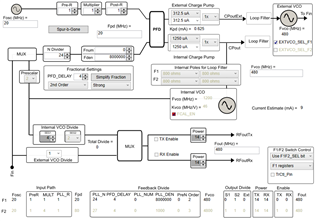

  • Hi Ghyslain,
    Here is my register setting with 20MHz input and 480MHz VCO. What is your input and output frequency in your configuration?

  • Hi Noel,
    Input frequency is 10MHz and the output is 819.2MHz. The external VCO is a VCXO with a slope close to 11kHz/Volt.
  • Hi Ghyslain,
    Is the 10MHz TCXO? If this is the case, you need to make R34[15] = 0, otherwise, there is not sufficient input to the PLL.
    Since you are using a VCXO, use a scope to check the Vtune voltage to see if it is a flat trace or triangle waveform. If you see triangle waveform, that means the input impedance of the VCXO Vtune pin is low, you need to either increase fpd or charge pump current to compensate for the leakage current.
  • Hi Noel,
    No action by modifying the R34 register (R34[15]=0) but when we make CAL_EN (REG0[0]) bit to 1 and return to 0 then the detection function works. Do you confirme that it is necessary to make thos to activate or refresh the function?
    Also, the input impedance of the VCXO Tune is probabaly too low regarding the charge pump current. We work about this.
  • Hi Ghyslain,
    It seems that we need to make R0[7]=1 after a Vcc power up or a reset, otherwise, we need to toggle the FCAL_EN bit to make lock detect function. I didn't know R0[7] has this function.
    In summary, you can make R0[7]=1 all the time, you don't need FCAL_EN=1 as you are not using the internal VCO. Lock detect works in PLL mode.
  • Hi Noel,
    for our application it is more simple to toggle the FACL_EN bit  but set the R0[7] to 1 works also.
