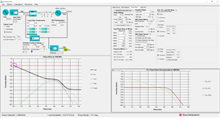

On simulating the Output 100MHz Phase noise in PLLatinum sim software, -4dB degradation in phase noise is observed at 100Hz offset as shown below,
Query:
1.Since phase noise is of utmost importance for our application, Kindly confirm if the phase noise degradation will not exceed -4dB degration i.e, -126dBc/Hz @ 100Hz offset when using LMK04832? or will practical implementation incur additional degradation?

    Thanks for pointing out, I have changed the device as suggested, also since i need the sysref of all LMK04832 to be phase aligned, I changed the PFD frequency to Sysref frequency(5MHz) to comply with the Zero delay rule(Since LMK04832 has R divider sync, Input need not be GCD(VCO,Sysref), right?)
    With the above change, On simulating the Output 100MHz Phase noise in PLLatinum sim software, -4.2dB degradation in phase noise is observed at 100Hz offset as shown below,

    Regarding your query on the 100MHz output phase noise degradation @100Hz offset, the LMK04832 has an Norm PLL flicker -128 dBc/Hz @ 10kHz offset (see the note 6 to calculate the phase noise at required output frequency) and at 100MHz output the phase noise will be around -148 dBc/Hz @ 10kHz offset with 10dB/decade slope close to carrier. Hence the device has an close-in noise at 100Hz offset (PLL noise) would be around -128dBc/Hz.
    This is the best phase noise, you could get when your reference is at least better than 6-10dB at 100Hz offset.

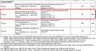

    Is <10ps phase alignment of sysref possible with above scheme?
    The SYSREF alignment between the parts can be possible but the device itself is having CLKout to CLKout skew 60ps. Hence, the phase alignment can vary in this range.
