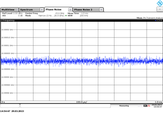

I am currently using the LMX2595 at +85C in Full Assist mode with a calibration ran at +85C
We are seeing a problem when tuning to the end of the VCO7 core where on an SSA, the frequency looks very noisy (not unlocked just poor looking). I can provide a graph of it at +85C once I obtain, I've attached what it looks like at +25C
At hot, the "settled" frequency is much noisier (think zoomed in)

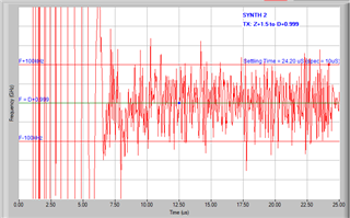

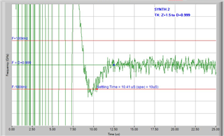

  • here is the settling time at +85C and the phase noise at +85C

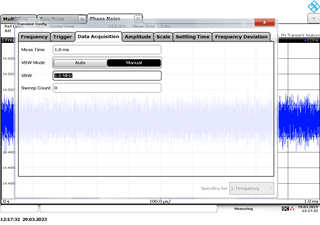

    When I measure transient response, I will adjust VBW accordingly, especially at "Narrow band", otherwise it will be too noisy to read the data.
    For example,
    Were you using the same VBW (or something similar, depending on the test equipment) for 25C and 85C measurement?

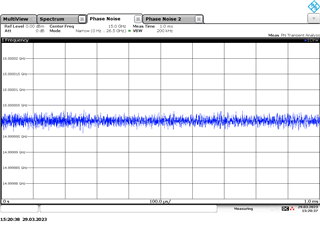

    Below is the transient measurement at 15GHz at 25C and 85C, VBW = 200kHz. There is no obvious difference.
    25C
    85C

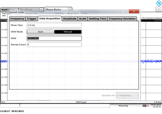

    I turned on a smoothing function on my E5052B SSA and it got rid of the noise, but I'm not sure how much that helps my performance since it's smoothing it (lipstick on a pig?)

    With E5052 narrow band transient measurement, we need to set the proper "Frequency Range". Setup --> Freq Range.
    This is not a smoothing to the DUT's performance, it is a smoothing to the test equipment. This smoothing is similar to spectrum anlayzer. When we use Full Span, the noise floor is very high because RES BW and VBW are big. With 10kHz span, for example, we need to use (usually automatic) a smaller RES BW and VBW so that we can see the real noise floor of the signal.

  • That's what I thought looking at my parameters, with smoothing turned on it does have a good transient response so I'm attributing the noise to perhaps sensitivity in my loop or measurement
