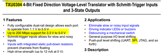

Is there a level conversion chip with SPI communication clock above 32MHz?
Hi Fang,
Please see Is there a level conversion chip that supports I2C and SPI, and the communication clock for SPI level conversion is not distorted above 25MHz? for recommendations.
For example, the below is from the TXU0304 datasheet (5V to 3.3V up to 125Mbps i.e 62.5MHz), thanks.
