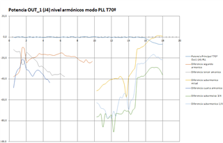

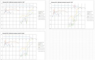

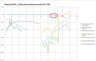

We have been using this LMX2595 in a production line and this is the fist time we see that output power goes down between 13.3 GHz and 14 GHz.
Firstly we tested the lmx2595 with eval board and then we manufactured a board with more RF components
After this component we use a RF chain with an input switch to select between the output of the PLL or an input signal. We work 500MHz up to 18 GHz.
The RF chain (switch included) works as spected with the external input signal but we have problems when we use the signal from PLL , specially working at T=70ºC. We have no problem between -40ºC and 25ºC
Resistors and capacitor are close to LMX in layout
Woould you be so kind to tell me we do we have a problem with LMX2595 at hot temperature?

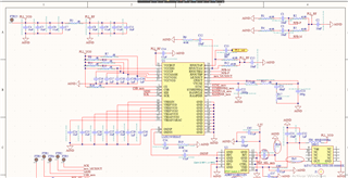

If you send me an email I will send schematic we are using. I tried to add a picture/file but I was not able to paste this information.
