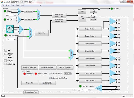

unfortunately I got a new PC which is running with Windows 7 64-bit. Having installed the CDCE72010 Control GUI v1.2.8 the USB driver is not working. Tool -> Force USB Driver Install comes with Error 5.
Is a driver available?

    I may be able to send you a new version of the GUI very soon that can support 64-bit. Let me look into this and get back to you shortly.

    The main issue of the Gui is that the display doesn't show any information on internal clock frequencies, In/out buffer type, etc etc. From one to another settings file, it's pretty difficult to see what has been set

    Yes, here is the latest version which includes an installer for 64bit systems. We hope to release this to the web by end-of-year. 2330.scac100b.zip
    Also, here is the 64-bit driver if you want to continue using the version of the GUI you have: 3733.CDCE72010_64bit_Driver.zip

    I see some GUI bugs I had pointed out in other posts here are fixed, but also some useful features are missing.  There is now no Divider START DETERM-Block function.  Why has that been removed?
    It's now Feb2012 but I still don't see where this has been released, other than the 'secret' link given above.
    On the good side it did install and work fine on my Win 7 64b PC.

    Sorry for the slow response. I know the Divider Start Determ window was removed, but I think this might only be because there are TI reserved bits featured in this window and it was reasoned that the SPI register window can be used for these settings. Based on your feedback, it might be good to add this back if user's find the GUI diagram more helpful.
    There has been a delay in the official release. We have a couple more items to finish implementing on the loop filter tool and we hope to get this release as soon as our software developer has the bandwidth.

  • Yes it's quite useful and the functional diagram shown under that button is not to be found elsewhere.
    I'm not sure how removing it and having me bit twiddle for these selection protects your reserved bits.  I might just twiddle the reserved bits while I'm twiddling the others anyway, so where is the protection?
    I vote to put it back in, and you can grey out the reserved bit selections if you want.  That's how it's usually done.
