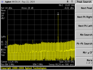

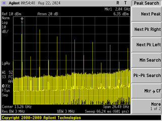

But when we change the frequency to above 11.3GHz, we found two points:
1.When we set as below, disable the tracking filter(with DBLR_CAL_EN=0), the output power will be lost in some frequency area between 11GHz to 19GHz, it is showed in the pic.
a. Program INSTCAL_PLL_NUM, PLL_N, PLL_NUM and PLL_DEN (if their value have change)
b. Program R0 (with FCAL = 0, DBLR_CAL_EN = 0) to change VCO frequency
output from 11GHz to 19GHz

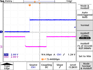

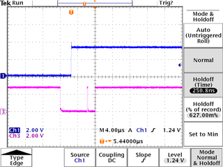

2.When we set as below, enable the tracking filter(with DBLR_CAL_EN=1), the Frequency Lock indicator LD signal will remain to low when we swtich the frequency point in a very tiny time, just like several hundreds of microseconds.
Can anyone help to solve the problem when we want to quickly switching the frequency points between 2GHz to 20GHz. Thanks a lot.
  • Hi Lucas,
    In step 3, did you set INSTCAL_DBLR_EN = 1?
    After step 12, did you see the LD pin turn HIGH? If not, we need to program RESET = 1 to reset LMX2820. After it is reset, repeat step 8 to 12.
    This is a proven programming sequence. Here is the test data using this sequence.
    Spectrum at 2GHz and 20GHz.
    Lock time from 20GHz to 2GHz.
    Lock time from 2GHz to 20GHz.
