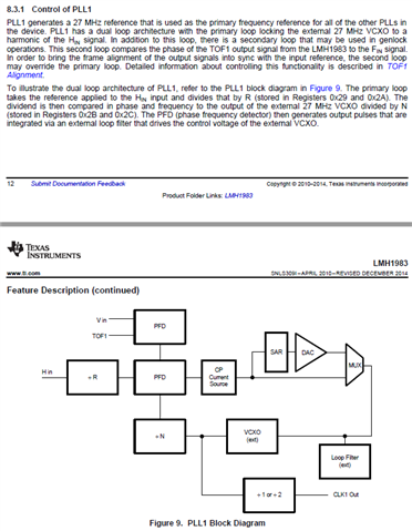

    In section 8.3.1 of the datasheet, it shows that PLL1 has a primary loop and a secondary loop.
    TOF1 is used for the secondary loop of PLL1.

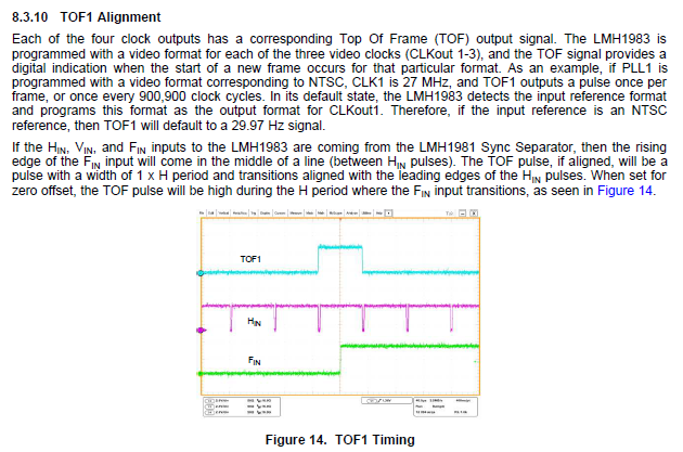

    Section 8.3.10 of the datasheet states that TOF1 is output when the Fin input is transitioned.
    In other words, F is considered to affect the secondary loop of PLL1.

    Datasheet Section 8.3.6 told us that the lock state of PLL1 depends on H only.
    In section 8.3.7, it told us the lock time may depends on TOF1 alignment. If we disable TOF1 alignment (NeverAlign), I expect PLL1 will not have dependency to F anymore.
