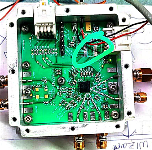

We have purchased the LMX2582 eval board so that we can evaluate the performance before using it in the system. After evaluation, we have developed the PCB as per Gerber provided by you for eval with the simple addition of an uC on the same PCB for programming.
We are using two LMX 2582 developed as per Gerber provided for EVAL in a cascade where one acts as a reference clock and another as LO for the Mixer. The first LMX2582 module is programmed with external uC. Individually standalone when the results are checked the phase noise appears acceptable for the first LMX2582 but after cascading the second LMX2582 phase noise is degrading at 10KHz suddenly since last week, it was working fine even when cascaded. The results are still fine if we simply program the first LMX2582 using USB2ANY and TI GUI in cascade. The phase noise at 10 KHz offset is dropping from -112 dBc/Hz to -93 dBc/Hz at 1205 MHz.
We do not understand what is the reason that is causing the issue, please guide us. Let me know if you need any supporting documents.
Below is the PCB image with uC removed and PLL programmed using USB2ANY. The connector we made was based on pin data.
The schematic for the above board is attached below:

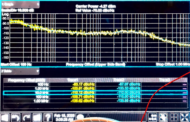

In the above case, the cascaded phase noise is acceptable as shown below,
When the uC is either connected to PCB or we even tried connecting the uC on a separate PCB and programmed the PLL through the connector to check if the uC is a problem or the placement of the uC is a problem, but even when the uC is connected outside the cascaded phase noise is degraded. The results are degraded even after replacing or changing the uC with a different version. The degraded results are shown below:
The results are fine only when the first uC is completely disconnected from the system or programmed from USB2ANY.
We have used the default loop filter of the EVAL board in our design.

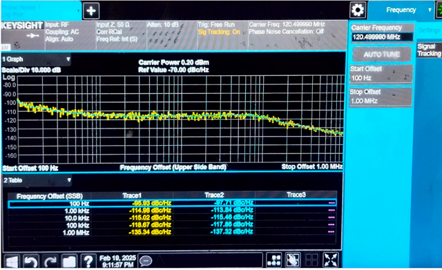

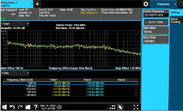

    Can you verify the first synthesizer output with USB2ANY and MCU?
  • Yes, we compared both, The following are the results,
    Below is the result with USB2ANY
    Below is the result with MCU
    Both appear to be acceptable, with 3dBc variation observed in a 10KHz offset.
  • Hi Akshay,
    With your configuration and settings, assuming a noiseless 40MHz reference clock, the phase noise of the first board will look like below.
    Your data is higher than simulation because the reference clock is not noiseless and the test equipment does not have low enough noise floor.
    Any way, if you use this output as the reference clock to the second board, you will get below phase noise.
    Basically, the output phase noise is dominated by the reference clock. In other words, the phase noise of the first board must be very good, otherwise the phase noise of the second board will be affected.
    Back to the original question, why is the phase noise worst with MCU? I don't know. If the 40MHz reference clock is an external source (e.g. signal generator), then the MCU shall take the full responsibility to the phase noise degradation. If you have a high frequency probe, you can probe the MCU to see if it generates noise.
    In your layout, do you have any digital traces run underneath the loop filter?
  • Thank you for the response and for taking the time to investigate our issue.
    We could diagnose the issue and even correct it. The reset register was not programmed as per the recommended sequence. The cascaded phase noise is restored after correcting the reset register programming sequence even when programmed with MCU.
