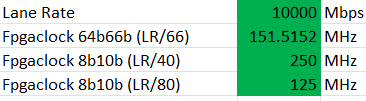

    However, I have this generic spreadsheet that might help understand this quicker based on your specific config.
    Please see attached.
    Rob
    Lane Rate Calc GUI.xlsx

  • Hi Rob,
    In the Lane rate calculation excel sheet, there is the formula as follows:
    Lane Rate = ((Sampling Frequency)/(decimation))*(#bits/sample)*(encoding) * (I/Q Channels) * (# of Channels) / (#lanes)
    In the datasheet, the line rate formula is given as follows:.
    f(LINERATE) = fS x R
    Can you explain the line rate calculation for JMODE=0?
    Liston

  • Hi Rob,
    The FPGA Clock Calculation from the Excel that you shared has separate formulas as mentioned below.
    For 8b/10b, there are 2 separate values: LR/40 and LR/80. Could you please explain this?
    Liston
  • Liston,
    Some customer use a line rate of /40 or /80 for the FPGA clock, this is your choice on how you implement the FPGA FW.
