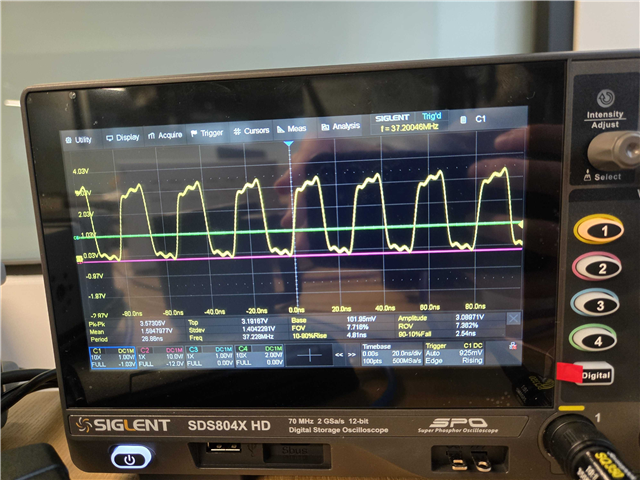

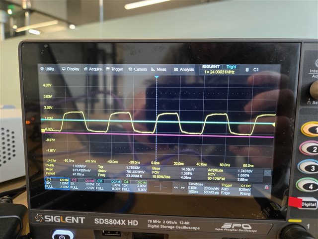

    Scope shots of the XO (measured directly next to the LMK chip):

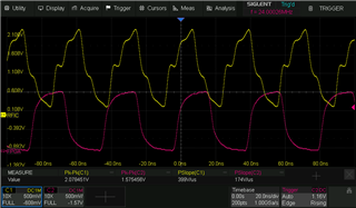

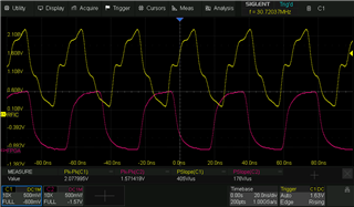

    Scope shot of the 30.72 MHz SECREF input:
    This is confirmed to be the correct SECREF input when measured on Pin 10 (SECREF_P) of the LMK05318B.

    • I don't see an issue with the XO input waveform. That looks within spec. Plus the LOS_XO and LOS_FDET_XO are 0 which tells me the XO input is within frequency (10 MHz to 100 MHz) and amplitude spec.
      • With that said, can you confirm that the LOS_XO_FDET_INTR and LOS_XO_INTR remain cleared? If these bits are toggling then this can indicate something is wrong with the XO input. If they are not toggling (stay cleared), then the next step is to examine the APLLs.

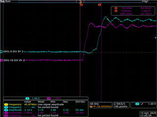

    If you "zoom in" on the scope by adjusting the time base, can you show the behavior of DPLL R and DPLL FB? Close enough to see only one edge of each signal. Trigger on DPLL R.
    I would need to see how the DPLL FB DIV BY2 is behaving respective to the DPLL R DIV BY 2. It's OK for the two signals two be in-phase or 180 deg out-of-phase as long as we see the two edges aligned. The 180 deg out-of-phase is acceptable on the status signals because the dividers (DIV BY 2) on the two status signals are not SYNCed.
    Something like this:
    Based on the behavior of the APLL NUM STAT, it looks like the DPLL updates are not occurring, at least how it would be expected. It seems that the DPLL isn't tracking the REF properly. The BAW LOCK goes low because the VCO is now tracking the REF not the XO input. If you see the output frequency deviate from 40 MHz, it's because the DPLL is now following the REF input (or trying to follow it).
