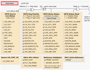

We have the following status bits when we flash our LMK chip:
  • 'LOL_PLL1': 1
  • 'LOL_PLL2': 1
  • 'LOS_FDET_XO': 0
  • LOS_XO': 0
  • 'HIST': 0
  • 'HLDOVR': 1
  • 'LOFL_DPLL': 1
  • 'LOPL_DPLL': 1
  • 'LOR_AMP': 0
  • 'LOR_FREQ': 0
  • 'LOR_MISSCLK': 0
  • 'REFSWITCH': 0
Meaning that our LMK chip's DPLL cannot lock on, even after waiting for several hours (~12 hours) to the lock to be established. We have measured the pps signal and XO input and they are valid signals, using an oscilloscope. The LDO power supplies are working properly.
Any input and recommendations to achieve a DPLL lock would be appreciated, or further debugging steps.
  • Hi Arpad,
    Can you please upload the .tcs and schematic to the e2e forum? I am unable to open the Google Drive. If you click Insert then Image/video/file, you should be able to upload.
    I'm also observing that APLL1 is not locked (LOL_PLL1). If the APLL does not lock, then the DPLL will not lock. There is either a configuration issue or setup issue. Let me take a look at the .tcs file once you upload it to e2e.

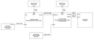

    We are testing your .tcs file on the LMK05318B EVM and have some data, as well as questions. Video below shows TICS Pro + Scope.

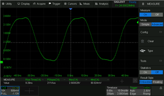

    Screenshots:
    Scope inputs:
    Yellow: LMK OUT5_P (40MHz Output)
    Pink: LMK OUT7_P (1PPS Output)

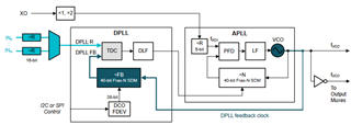

    Blue: Stat0 Pin (DPLL R Divider, div-by-2)
    Green: Stat1 Pin ( DPLL FB Divider, div-by-2)
    I collected DPLL FB and R Divider values after reading this very useful post.
    Observations: 1) Blue and Green traces start out phase aligned roughly 10 seconds after the soft-reset command. This also corresponds to a very brief (several seconds) time where DPLL_LOFL is unset. However slowly the Blue and Green trace edges drift away and DPLL_LOFL remains checked upwards of an hour after soft-reset. I think this means we have to fine-tune the PhaseLock and FrequencyLock detect?
    Can you help us interpret this behavior, and is this what's expected on the eval board?
    I also wasn't able to adjust the DPLL BW below 0.01 Hz. Is this the absolute lowest allowed, or was it a TICS software issue?
    Thank you

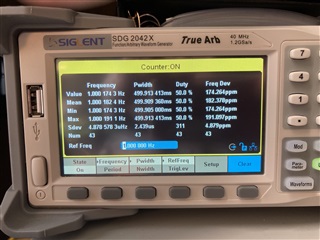

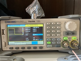

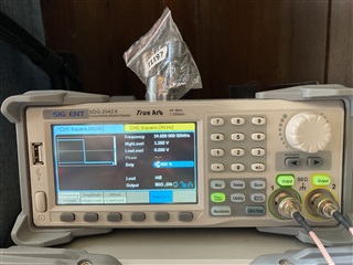

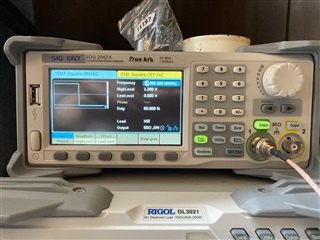

    EDIT 1: Signal generator input to the EVM:
    • Out 1: 24MHz square wave (50% duty cycle), 1.8Vpp connected to XO_P
    • Out 2: 1Hz square wave (10% duty cycle), 3.3Vpp connected to PRIREF
    Using a Siglent SDG 2122X (120MHz). The two channels are NOT phase synced.

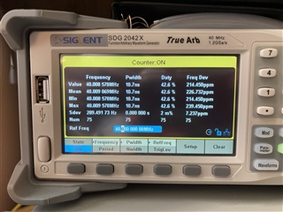

    EDIT 2: Output signal stats (40MHz and 1PPS):

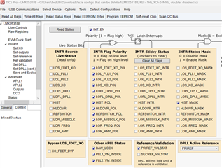

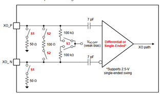

  • Hi Quint,

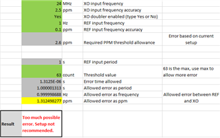

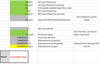

    1. It seems like the DPLL is unable to frequency and phase lock with your setup/config.
    2. I was discussing with my team about this and the XO doubler, which changes the phase detector frequency, impacts the allowed error for the 1PPS phase detector.
    3. Please refer to the attached spreadsheet to view the acceptable XO input and XO doubler setting to use with the 1PPS phase detector.
      1. 3404.1pps phase detection calculator.xlsx
      2. A 24 MHz +/- 2.5 ppm XO input with the doubler disabled is an acceptable setup.
      3. A 24 MHz +/- 2.5 ppm XO input with the doubler enable is not an acceptable setup and you may struggle to get the DPLL to lock. This is because the 1PPS phase detector is limited to a maximum counter value of 63 which in turn limits how much error is allowed between the XO input and REF input. The previous config (2025-04-11, ti-2.tcs) used a setting with the doubler enabled.
      4. With the previous config, I struggle to lock when XO input is 24 MHz + 2.5 ppm. If the XO input is 24 MHz + 0 ppm, then the DPLL can lock within 5 to 10 minutes. Please note that in my setup, I use signal generators (which likely have an integrated highly accurate OCXO) to source the XO input and REF input.
    4. Can you try with this other file?
      1. LMK05318B, REF=1Hz, XO=24MHz, doubler disabled.tcs
      2. In this file, I have disabled the XO doubler to allow more error between the XO and REF inputs.
      3. In my testing, the DPLL can lock with XO = 24 MHz + 2.5 ppm error applied.

    2) At a high level, to get the DPLL to lock, we require the 1PPS cycle-to-cycle jitter (T_jitter) to be less than the threshold set by the 1PPS Phase Detector (e.g, 2.63us in the config you sent), assuming a perfect 0ppm XO input clock.
    So any TCXO ppm error will decrease the PPS T_jitter margin? This would suggest it's equally important for us to understand our 1PPS T_jitter and ensure it's sufficiently low (i.e. satisfies the requirements described in TICs, shown below). Is this understanding correct?

    2. Right, the 1PPS phase detector is a counter (with a max value of 63) that bases the 1PPS input phase measurements against the XO input. This means the 1PPS frequency error and the XO frequency error both impact the ability to lock to a 1PPS input.

      1. Have you been able to confirm that the programming occurred as expected? In other words, compare a register dump of intended registers against the programmed registers?
      2. Also, please capture the PRIREF_VALSTAT register (R411[2]) to check the status of the PRIREF validation.

  • Hi Jennifer,
    I tested your config with signal generator as the source for both XO and PRIREF, but was not able to replicate your results on my evaluation board. In addition I see a PLL VCO frequency output error when reloading the DPLL values or rerunning the Matlab script (video #2), although it does not show the error upon initial loading of the file in TICS. I assume this isn't good but not sure
    Setup:
    Description: Using eval board, programmed via TICS Pro.
    Config file: LMK05318B, REF=1Hz, XO=24MHz, doubler disabled.tcs (From your previous message)
    XO input: 24MHz, signal generator
    PRIREF: 1PPS, signal generator. Phase locked to XO internally in the signal generator.
    Observations:
    - 48.00048MHz output within approximately 5 seconds of config load & soft reset ()
    - Briefly see LOFL_DPLL unset (~0:17)
    - When LOFL_DPLL becomes set again (~0:22), we see the frequency change from ~40MHz (40.00048MHz) to <39MHz.
    - After either reloading the DPLL values or rerunning the matlab script, I get a PLL2 VCO frequency output error (see video #2).

  • Hi Jennifer,
    I was able to load the config without the PLL1 error using your instructions, and I checked that the XO doubler was indeed disabled as R42[4] was unset. However I am getting LOS_XO in the status screen upon loading the config. I'm confused as to what's causing this issue--do you see anything incorrect in the attached files?
    In the meantime I'll triple check the setup and make sure I'm not overlooking something...
    SigGen Outputs:
    Ch1: 1Hz 3.3Vpp, 10% duty cycle. Fed into PRIREF_P
    Ch2: 24MHz, 2.7Vpp, 50% duty cycle. Fed into XO_P. (~1.1Vpp at LMK XO_P input after EVM voltage dividers).
    Scope Inputs:
    C1 (Yellow): OUT5_P. No output, but I presume this is due to DPLL_LOFL/DPLL_LOPL Mute settings?
    C3 (Blue): XO_P measured across R40 on eval board. It's >1V pp so I think this should be a valid input signal?
    C4 (Green): PRIREF_P measured across the (unpopulated) R21 pad on eval board.
    DPLL R and FB: (Never turn high...)
    EVM setup:
    - R42 removed (since we're feeding XO_P from SigGen instead of onboard XO).
    - R43: 0 Ohm
    - R41: 220 Ohm
    - R40: 240 Ohm

    Here is a more detailed example of my setup. I use the output of an LMK5B33216 (which is another network synchronizer) because that lets me get down to 1Hz and use it as the PRIREF input. Also, I get a square wave instead of a sine wave (from straight out of a sig gen).
    Additionally, I will be out of office tomorrow as it a TI US holiday. I will continue my support when I return next week.

    Thanks for the additional setup detail. I double checked everything & left the EVM to run for several hours without it clearing the LOS_XO flag. So I think it's reasonable to assume that the LMK chip on this eval board may be damaged**, and am attempting replacement (luckily I have 5x samples courtesy of TI). (If replacement doesn't work I'll order a new board.)
    Sounds good re: holiday, I think we have a path forward from this point & circle back with more results on/before Monday.
    ** For a few reasons:
    1) My sig gen setup hasn't changed at all over the past month+, and it's worked fine with the eval board(s) until yesterday.
    2) I know I've had the XO signal turned on before the eval board power was applied at least once, which I presume could damage it.

  • Hi Jennifer,
    I'm still in the process of replacing the chip, but I will check the default EVM config first as a baseline.
    However I wanted to ask if you had any guidance or documentation on the XO/TCXO circuitry, particularly AC vs DC coupled LVCMOS? (Aside from following the TCXO datasheet, of course)
    I had thought that the circuitry for one TCXO should work well for another, but I'm seeing a range of examples:
    1) Pletronics UCG4:
    2) Connor Winfield TV100/TV200:
    3) LMK datasheet:
    4) LMK EVM datasheet:
    5) XO specified in datasheet and EVM (same as #2):
    I understand the resistive voltage dividers required for 3.3V XOs to be compatible with the 2.6Vpp XO input, but I'm less certain on the DC blocking capacitors in #1 and #3. In addition, are there specs on the XO_P pin capacitance?
    -Quint
    EDIT: #6 Lastly, our board for comparison:
  • Hi Quint,
    Some devices or test equipment do not allow a DC voltage more than 0V, hence the oscillator output must be AC coupled.
    As long as the DC voltage specs of the XO meet the LMK05318B XO input datasheet requirements, it is OK to DC couple into the LMK05318B.
    The datasheet shows the following block diagram for the LMK05318B XO input buffer which has internal AC coupling capacitors (7 pF).
    In section 9.3.1 Oscillator Input (XO_P/N):
    Jennifer

    I just received my eval board, and after loading the default config we are getting the following status register output:
    It looks identical with the exception of BAW Lock..
  • Hi Quint,
    I can see that the APLLs are locked this is good enough to proceed to the next step.

  • Hi Jennifer,
    I loaded the config w/ XO doubler disabled, wrote all regs, and issued soft chip reset. We see the following statuses:
    And XO input signal:
    EVM board:
    NOTE: I made the following changes to the board at this step:
    - I changed the J12 jumper to 1.8V given we have only LVCMOS outputs.
    - I changed the J9 jumper to disable the onboard XO.
    Is there anything ekse I should adjust/change?
    EDIT: Incorrect status screenshot. Has been updated.
    EDIT 2: Here's the .tcs file used: 6153.LMK05318B, REF=1Hz, XO=24MHz, XO doubler disabled, XO no term.tcs

    Here's some additional test data collected from the new EVM:
    XO_P input (CH1):
    PRIREF_P input (CH2):
    (Note on sig gen: channels 1 and 2 are phase synced. I can turn off phase sync if desired for testing)
    EVM:
    Video of status outputs, along with scope displaying the OUT5_P 40MHz signal, as well as logic analyzer showing DPLL_FB (STAT0) and DPLL_R (STAT1) outputs. Scope is triggered on alternating edge of DPLL_FB. I start the timer when I turn on the signal generator for XO_P. The behavior is very similar to what we observed last week, but I'm not sure how to interpret it.
    Observations:
    - LOFL briefly goes low, then switches back to high a few seconds later. When it switches back, the frequency changes from ~40MHz to 39.967760MHz (which I think makes sense --we lose frequency lock). But I don't know why we would attain frequency lock briefly then lose it again. We seem to never recover frequency lock.
    - The output stayed exactly at 39.967760MHz for about 39 minutes, and then jumped to 40.04847MHz. It's stayed locked on that value through minute 46.
    - DPLL_LOPL and DPLL_LOFL remain high by minute 46.
  • Hi Quint,
    I suspect the arbitrary gen is the culprit here. We avoid testing with arb gens in our lab because they are too noisy and impact lock. A setup that requires a 1PPS input is susceptible to wander noise on the XO input pin. The plot below shows a generic phase noise plot of a DPLL+APLL output. You can see that with a narrow DPLL LBW (0.1 or 0.01 Hz for 1PPS), the XO/TCXO/OCXO input dominates the close-in phase noise region which is between the DPLL LBW and the APLL LBW (between 0.1 Hz to 1 kHz, in this case).
    Are you able to test with the 24 MHz TCXO that you plan to use in the custom board? For example, place it on a breakout board then connect to the external XO input SMA of the LMK05318BEVM. Alternatively, mount the TCXO onto the LMK05318BEVM; there are pads available on the EVM to solder down the TCXO (see the LMK05318BEVM User's Guide for the schematics).
    Jennifer

    An additional question--could you shed some light on the debugging utility of the DPLL_R and DPLL_FB registers in the LMK? (Even an explanation in a previous post, external reference, etc. would be useful).
    I'm aggregating our previous test data into proper test reports in order to better share with other technical folks during our meeting tomorrow after afternoon, if needed. In addition, we started testing 19.2MHz and 12.8MHz XO configs (to ease jitter constraints from the 1PPS phase detection reference validator) late last week to have a an alternative plan forward. I'll tried to have those reports in to you this morning but they are still in progress.
    -Quint
  • Hi Jennifer,
    Certainly, we can take the waveform generator out of the equation. Do you think it's causing bigger issues with the XO or 1PPS? In either case, could running the sig gen from a GPS-disciplined oscillator help? (It does have a 10MHz clock input, however we don't have a readily available 10MHz discplined clock..)
    For now we can remove the sig gen from the equation and stick with a TCXO. At 24 MHz, the highest stability we have in the lab is 2.5ppm (with XO doubler disabled should provide some headroom, per your previous analyses). We can also try with 19.2MHz 0.5ppm. We do have an XO breakout board which should help.
    For PPS, we'll just go straight from the ublox LEA-M8F GPS eval kit. (Same module as the final product).
    We should have data shortly.
    -Quint
  • Hi Quint,
    For the DPLL R and FB dividers:
    After the DPLL becomes active (HLDVR bit, R14[4] = 0), the inputs of the time-to-digital converter (TDC) can be checked to assess the DPLL lock state. The TDC compares the phase error between the DPLL reference clock after the R divider (DPLL R path) and the respective VCO output clock after the feedback divider (DPLL FB path). The TDC phase error is generated as a digital correction word and is filtered by the digital loop filter (DLF). The DLF output adjusts the APLL N divider numerator to pull the VCO frequency into lock with the DPLL reference.One way to check the inputs to the TDC is by configuring the GPIO status pins as the "DPLL R divided by 2" and "DPLL FB divided by 2" signals. The two signals represent the DPLL R divider and DPLL FB divider paths with a
    divide by 2 on each signal. If you don't see any of these GPIO signals move, then it means that the DPLL is not active and the device is in holdover (which coincides with the HLDVR bit = 1).
    Another status signal to monitor is the APLL numerator which can be readback as the PLL1_NUM_STAT register (R127 to R123). In TICS Pro, the register is found in the User Controls page and you can perform a readback for that register by clicking into the box then on your keyboard do: "CTRL + R". This status signal gives the current state of the APLL numerator which is controlled by the DPLL. If the value reads as 0 then the DPLL has railed off trying to track the input. If the value is non zero but not changing, then the DPLL is not active and the device is in holdover. If the value is constantly updating then the DPLL is active. Tracking this readback helps give us more insight on what could be happening with either your setup or configuration.

    We have been running the 24MHz config with the 24MHz TCXO (2.5ppm) w/ 1PPS from GPS (no XO doubler), but are still not achieving phase or frequency lock for the DPLL. Checking PLL1_NUM_STAT, we see the following:
    PLL1_NUM_STAT is very steady, it will change up/down a single unit every ~5 seconds or so ("Read Register R123...R127 .... No difference" shown in box in TICS, so it is reading this register.). Thoughts on where to go from here?
    We are also trying to understand better what could lead to performance discrepancies between evaluation boards in our lab vs yours when it comes to 1PPS locking. The XO source is of course one difference (frequency stability, etc.). Is there also a wide range of performance metrics when it comes to 1PPS signals sourced from GPS? Our waveform generator has a built-in frequency counter that's currently hooked up to our PPS, I'll share that data shortly.
    -Quint

    We also wanted to share a win--we loaded the attached config file (24MHz XO, no doubler, 30.72MHz SECREF) and were able to get DPLL lock in just a few seconds on the eval board. Our GPS has a 30.72MHz output signal builtin, so we can also go this route if needed.
    The main reservation with using the 30.72MHz instead of 1PPS for reference input is that (I think) we would no longer have a time reference (as we would not be able to extract the original top-of-second 1PPS signal from the 30.72MHz signal), only a frequency reference. While we could still provide a 1PPS signal from the LMK chip on OUT7, it would be of limited value because there would be no way to ensure the OUT7 signals from various LMK chips are actually synchronized to the same time, ie to the actual top of second time from the GNSS satellites.  Does this seem like a broadly correct assessment?
    There were some differences in understanding on the team of if/how 1PPS could be pulled from a 30.72MHz GPS-disciplined signal, so we were curious could help clarify.
    8535.config.tcs
    -Quint
    EDIT: Added status screenshot

    More good news, we have managed to achieve DPLL lock on the EVM with the 24MHz TCXO, 1PPS input, no XO doubler. We achieved the lock by 2:05:00, but it may have locked somewhere before the 2 hour mark. I will retry this test but with the higher stability 19.2MHz TCXO (again on the EVM).
    -Quint
  • Hi Quint,
    That is correct--if you use a 30.72 MHz reference, then you lose the exact phase that you could get from the 1PPS input. If you use a 1PPS input from the GNSS, then you get the phase and frequency accuracy of the GNSS. A non-1PPS signal such as 30.72 MHz from the GNSS gives the frequency accuracy only because the phase information is lost. The higher frequency would allow for a faster lock time (due to a larger DPLL LBW, typically 100 Hz).

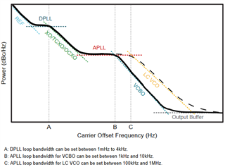

    Because of the narrow DPLL LBW, the longer DPLL lock times are expected. However, I provided a setting for DPLL LBW = 0.1 Hz which should give you faster lock time than two hours. We have observed longer lock times (up to 1 hour) from some of our customers.
    It is true that the XO input plays a major role. Prior to 1PPS lock, the VCO is locked to the XO input. The closer the error between the XO input frequency and the 1PPS input is to 0 ppm at the initial lock, the faster the DPLL can lock. Otherwise, with such a narrow DPLL LBW and low TDC rate (1 Hz), the DPLL steadily updates the APLL numerator and makes the phase corrections to reach 0 ppm between 1PPS input and the VCO output. This results in the longer lock times.
    Please keep me posted on the results with the 19.2 MHz TCXO. We can also discuss further during the meeting later today.

    One other area I realize we have not discussed is the DC hysteresis settings for XO and PRIREF. Could that be relevant here? Also, what is the DC hysteresis level? I don't see it listed..
    -Quint

    2. Confirm if a 3.3 V DC-coupled single-ended input is supported as the PRIREF/SECREF input. Edit: After discussing with my team, this is OK.
    Jennifer
