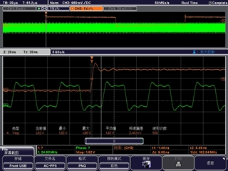

The 05318b used in our project is used as the jitter cleaner chip, with the input ref clk = 8kHz, the output out7 24.576MHz, the input mode is configured in DC mode, the corresponding register is reg40 0x07, and the register reg46 0x1c, indicating single-ended(internal termination 50 Ω). Since it is DC mode, the pin PRIREF_P of the 05318b chip is about 1.3V, and non-1.8V is at risk of being identified as low level. But the clock phases of he input and ouput are synchronized, it has no noise in audio channel.
after:
We configured according to the recommended configuration of TI engineers, modify the register reg40 to 0x03 AC coupled internally and reg46 to 0x18, indicating CMOS. And the PRIREF_P pin of the chip is 1.8V, but we found that the clock phases of the input and output are not synchronized, which also causes noise to be made on the audio channel we finally output.
question:
We want to know why the clock phases of the input and output are not synchronized when we change the dc mode to ac mode, and how to solve this problem and change clock phase to be synchronized.

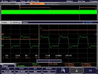

  • The attachment is 05318b PRIREF ac mode and dc mode, ac has different clock phases wave and dc has same clock phase wave.
  • DC mode
    AC mode:

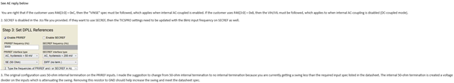

  • Hi ?? ?,
    1. Can you please provide the .tcs files you are using?

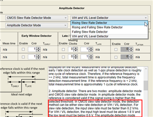

    2. Also, I'm not sure on the history of the AC buffer recommendation. The DC buffer path is the recommended input buffer setting for low frequency inputs (below 5 MHz) and is auto-configured in the TICS Pro GUI.
      1. The input decays when the signal passes through the AC buffer stage and is impacted by the hysteresis setting. The AC buffer stage has two hysteresis options: 50 mV or 200 mV. With a 50mV hysteresis threshold, it's possible that there are false edges detected if the 8kHz input has noise that fluctuates in and out of the threshold. With a larger hysteresis threshold, such as 200 mV, the input is less susceptible to the noise.
      2. The diagram below provides a general example of how the inputs is impacted by the AC buffer stage and hysteresis thresholds.
      3. Since your input cannot meet the minimum VIH DC coupled spec, I suggest increasing the hysteresis to 200 mV to improve the noise immunity with the AC buffer stage.
    3. Synchronization refers to output frequency phase and frequency lock to the input. There can be a propagation delay between the input and output but the frequency error between the input and output becomes near 0 ppm.

  • 1. tcs file has provided below.
    2.we will test this with ac hysteresis=200mv,current our config reg45 is 0x06,we change it to 0x07 to test.
    3.We want the phase deviation of the input and output to be in a very small range at different periods, rather than the phase deviation of each period is very large, such as the picture uploaded before.

    The zero-delay functionality on the LMK05318B is recommended for 1PPS input to 1PPS output: an open-loop synchronization scheme to align the 1PPS output on OUT7 with the 1PPS input. It is not recommended for higher frequencies like 24.576 MHz as the phase deviation is larger with the open-loop sync.
    Is the ZDM feature a must-have requirement in your design? We do have another network synchronizer, the LMK5B33216, which does support zero delay between the input and output for frequencies 1 Hz or greater.

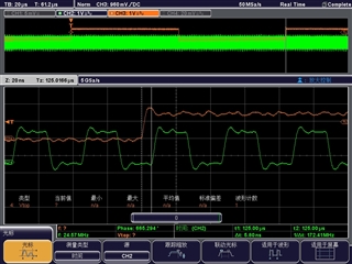

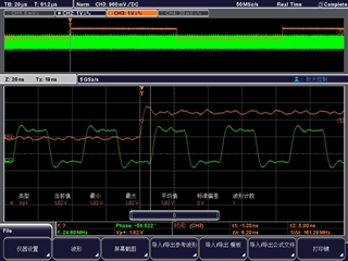

  • Hi
    Thanks for your reply to explain zero-delay case.
    like my colleague said, we hope the phase deviation between input and output  to be very small range,
    we use DC configuration, measurement the delay time is approx. 4.8ns between input and output;
    DC-8kHz-24,576MHz
    but use AC configuration, measurement the delay time is approx. 10ns between input and output
    AC-200mV-8kHz-24,576MHz
    Could you help to tell us how to decrease the delay time between input and output at AC configuration mode?

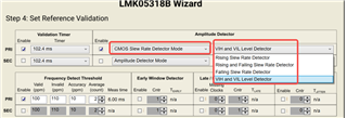

  • Hello Jennifer:
    We want to phase deviation of the input and output to be in a very small range at different periods, rather than the phase deviation of each period is very large, could you give some advice and based on my tcs file, does it have any problems?
    Sorry for the delay. I was out of office on Friday.
    Can you please confirm that the DPLL locks in your setup? Please readback R13, R14, and R411. Or send a picture of the Status page in TICS Pro after clicking on the "Read Status" button.
    With the previous config you sent, I cannot get the DPLL LOPL and LOFL flags to clear. After running through the Wizard again, I created a new config where I can attain DPLL lock:
    2025-04-21, XO=24.000 MHz, REF=8KHz,CH7=24.576 MHz, AC hyst=200mV.tcs
    Jennifer
  • Hi:
    Later I will get the correct information through the tool  to read 05318b register status. Currently, we can see our configuration through the code.
    laterly, i will try to test the new config tcs file to check.
    The R13, R14, R411 are live status register settings that give the state of the DPLL loss of frequency and phase lock as well as the reference validation status. Please provide the live readback of these registers when the LMK05318B is programmed and operational.

    1. Thank you for clarifying, so with a PRIREF voltage of 1.3V, you consistently have no issues (no pop sound is heard at all)? I am wondering if the test is repeatable and if as soon as you change the PRIREF voltage to 1.8V you can see the impact with the Bluetooth pop sound.
    2. R14 is a read only register which reports the live status of the device. If R14 = 0x00 after performing a readback, then the DPLL is phase and frequency locked to the 8 kHz input. There is no concern here in terms of DPLL lock between input and output.
    3. I compared the register differences between the original and new configuration file and saw there are differences in the DPLL loop filter and reference validation settings. Such registers impacts the the DPLL frequency and phase lock. This could explains why the DPLL cannot phase lock on my setup with the original configuration.
    Jennifer
  • Hello jennifer:
    I am sorry to feedback you laterly.
    1.Yes
    2. R14 is a read only register, Then I read R13 R14 R411 registers,R14=0xC0,it means not lock with frequency and phase, i do not know why it can't locked with input and output. Please help to check this, thankyou.
    3. By the way, i have another question, Can we increase the output waveform intensity of output7, similar to adjusting the driving force of output7.
    For #2,
    Can you also check the PRIREFVAL_STAT register, R411[2]? I want to confirm there is a valid input present; otherwise, the DPLL will not lock.
    Also, are you using this config file? "XO =24.000 MHz, REF=8KHz,CH7 = 24.576 MHz, DC hysteresis enabled, SE no term-test R14-0x00.tcs"
    For #3,
    The only options to increase output swing is by switching between AC-LVDS, AC-CML, and AC-LVPECL, where AC-LVDS has the lowest swing and AC-LVPECL has the highest. The LVCMOS output swing cannot be adjusted and is 1.8V.
    Jennifer
  • Hello
    For2:R411 register is 0x04, i think it was ok,can you have more advice with DPLL not lock?
    For3: I will do more check for this, thank you.
  • Hi ,
    For #2, if there isn't a valid input present, the DPLL will not become active and the device remains in holdover (locked to XO input). A valid input means that the enabled detectors report as true. The possible detectors are frequency detect, early/late window detect, and the amplitude detect. I mention to check the REF VAL STAT status bit because it can help indicate to us if there is 1) an input present and 2) a valid input present based on the enabled detectors.
    Confirming that R411[2] =1, is the first step in the debug. Please check first.
    Jennifer
  • Left a message for status tracking.
  • Are there any updates on #2 debug request?
    Jennifer
  • Hello jennifer:
     I am sorry later to reply to you, that R411 register is 0x019B04, bit2 is true.
    Thank you for confirming that PRIREFVAL_STAT = 1 when the DPLL is not locked (R14 = 0xC0). This behavior is not expected.

    I also tried two similar tcs files and found that the one music sounds are normal after soft-reset. I also found that R14 and R411 are in normal states, and the other one has no sound, and there are exceptions in R14 and R411 states. Please help compare these two tcs files to see where the difference causes the difference in R14 and R411 states. After soft-rest, dump registers
    That is the normal one.
    2335.XO =24.000 MHz, REF=8KHz,CH7 = 24.576 MHz, DC hysteresis enabled, SE no term-test.tcs

    That is the abnormal one.
    XO =24.000 MHz, REF=8KHz,CH7 = 24.576 MHz, DC hysteresis enabled, SE no term.tcs

    OK, looks like you have found a file that gives you DPLL lock and PRIREF is valid. Can you specify how you generated the file "2335.XO =24.000 MHz, REF=8KHz,CH7 = 24.576 MHz, DC hysteresis enabled, SE no term-test.tcs"?
    Let me compare the two (pass and fail) files and update you with findings tomorrow.
    Jennifer
  • I can't remember which registers were modified at that time. You can compare the two files you sent and help check which key registers affected the DPLL lock.
    By the way, based on our current input and output frequency, is the recommended configuration mode DC or AC better?
    The main differences I see is that you have less reference validation detectors enabled in your "passing" config (2335.XO =24.000 MHz, REF=8KHz,CH7 = 24.576 MHz, DC hysteresis enabled, SE no term-test.tcs). The amplitude detector is the only detector enabled in the passing config. Also, the amplitude detector is set to VID single-ended in the passing.
    I do also see a few DPLL registers (R264, R272 to R274Z) that differ; however, it is unclear how you were able to get different values from the GUI with these two configs.
    Can you try enabling the frequency detect threshold to see if you get REF valid and DPLL lock? Ideally, you have more than one REF detector enabled for a more robust solution. So try with the amplitude and the frequency detectors enabled. These are the settings to test:
    In terms of the DC or AC, it is preferred to use the DC setting for the low frequency inputs (such as 8 kHz).
    Jennifer

    I see that the "passing" config is not consistently locking. It seems that the CMOS VIH and VIL detector is failing which could be because the input swing is dropping below 1.8V.
    From the Reference Validation page in the GUI:
    •  In CMOS slew rate detector mode, the detection method can be either slew rate detection or VIH / VIL detection. For slew rate detection, the input slew rate must be faster than 0.2 V/ns. For VIH / VIL detection, the input high level must be above 1.8 V and the low level must be below 0.6 V.
    1. Can you please check if the amplitude remains at 1.8V or higher? I believe you mentioned the PRIREF input was marginal. I want to see if the PRIREF input is less than 1.8V when the readback status says DPLL is unlocked.
    2. Another thing to check is to use the slew rate detector instead of the VIH and VIL detector. However, this can only be used if the slew rate is greater than 0.2 V/ns. Can you please check the input is > 0.2 V/ns? Here is the config to test if your PRIREF input meets the slew rate requirement:
      1. 2335_LMK05318B_pass_slew rate only.tcs
    3. Additionally,can you please provide these details:
      1. LMK05318B schematic
      2. Frequency accuracy (in ppm) of the XO input
      3. Frequency accuracy (in ppm) of the PRIREF input
    4. Also, only one soft-reset is necessary to perform the PLL recalibration, you may follow this flow:
