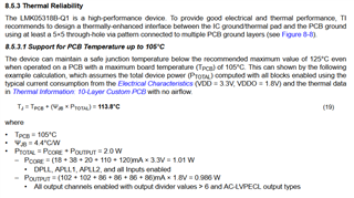

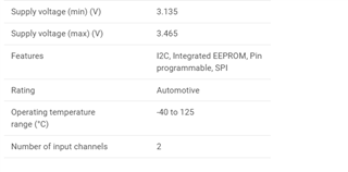

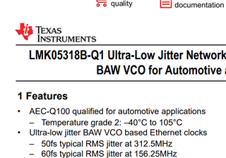

Dear Team,
please refer the attached image.
The attached images shows that the following part numbers temperature is given as -40 to 125° in the product page but in data sheet it is provided a s -40 to 105. Which one to be followed and what range will it really support
Please provide the clarification.
