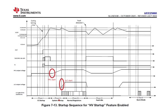

    Below screenshot is from UCC26650. I am not able to understand how PFC DC link voltage is ramping up before LLC switching starts. Auxiliary winding supply from LLC stage is not available as LLC switching is not started but still PFC soft start is shown well before LLC.
    In case of UCC25640x, RVCC is supplied to PFC controller. How this is happening in case of UCC25660x?
    Dhananjay
    Thanks for the response
  • Hi Dhananjay,
    In UCC2566xx, The HV startup of the LLC controller charges both the LLC VCC capacitor and PFC VCC capacitors. So, thats the reason you see PFC output voltage ramps up even before LLC starts switching.
    Manikanta P

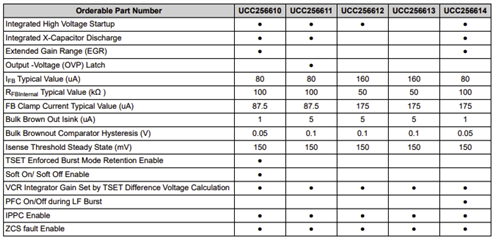

    thanks for the response. I will explain again the requirements of the application:
    input AC voltage: 3 phase, 480V L-L max
    PFC DC link voltage: 800V
    LLC output voltage: 24V/21A ~ 500W
    MCU is not used and standalone power supply shall protect itself and restart in below  fault conditions:
    additional flyback to supply gate driver / pwm ICs need to be avoided.
    1. PFC dc link OV/UV
    2. 24V output overcurrent and short circuit
    3. 24 output OV/UV
    A. based on the previous discussion, ucc28180 and ucc256602 looks to be good option. please confirm this combination of controllers as a standalone power supply unit without need of additional flyback and MCU as explained above.
    B. Rectified input three phase AC is rectified using six diodes, same will be provided to H V pin of controller. And we have selected 02 option of controller without integrated X discharge feature as rectified AC will have DC component and won’t cross zero.
    thanks
    regards
  • Hi Dhananjay,
    Sounds good. The UCC28180 and UCC256612 would be a good option. Please keep in mind that we have released the UCC256612 now which is P2P with the UCC256602. We have no plans to officially release the UCC256602.
