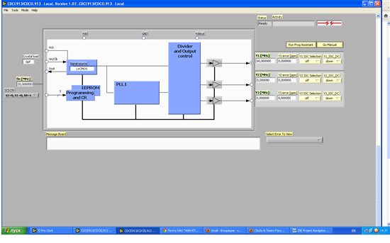

We use TI Pro Clock in local mode for I2C program CDCE913. We want: output Y1=60 MHz, Y2=0, Y3=0,  fin=20 MHz, signal source LVCMOS. After export to txt file we have the next. (See attach). After program chip we have on Y1 6,67MHz, instead of 60 MHz. What's wrong we do?

    thank you for you interest in our device. I uploaded your .txt file in the CDCE913 and I realized that the Y1 was generating 26.6667Mhz (maybe this was a typo in your previous post). Basically you set the PLL1_0 to generate Y1=60MHz, but you are selecting S0=1 which will load the PLL1_1 setup. This one generates the 26.6667MHz.
    For more detail I attached a file with some GUI screen-shots where I highlight this not correct configuration. I also added a modified .txt file which will make the Y1 to be 60MHz in case S0=1 and tri-state if S0=0. You can further modify it if my proposed configuration does not fit with you application. By the way, what is the application where you are using the CDCE913?

  • Hi Leandro,
    Thank you, all works fine.
    Sergey
