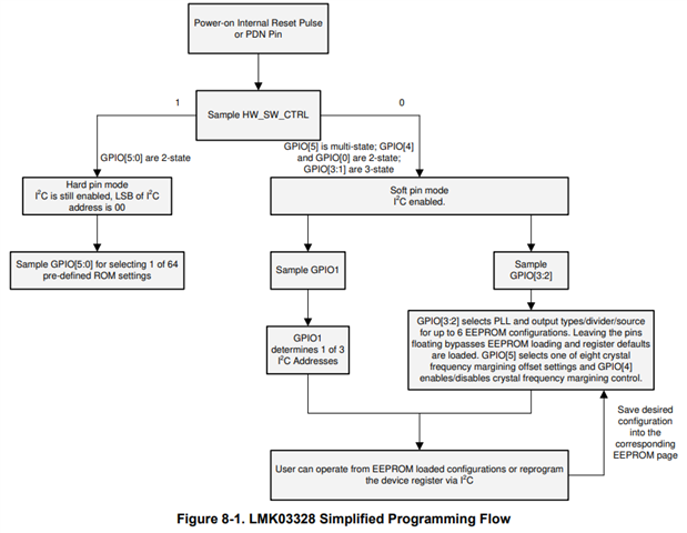

    GPIO2 and GPIO3 can be used to select the EEPROM page, just note that this cannot be done dynamically. The page needs to be selected at startup. Toggling the PDN pin as well can be done to change the page, per the below diagram:

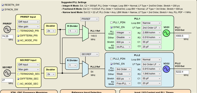

    The following is a supplementary explanation of the configuration using two PLLs simultaneously.
    ◎To create a video output clock of 148.5 MHz and 148.351648351648 MHz, the PLL Loop BW setting must operate in Narrow band Mode. For input clocks of 74.25 MHz and 74.175824175824 MHz, the Doubler at the LMK03328 input must be set to ×2. The effect on the output clock is an increase in spurious signals.
    ◎To create an audio output clock of 12.288 MHz, the PLL Loop BW setting must operate in Fractional-N Mode.

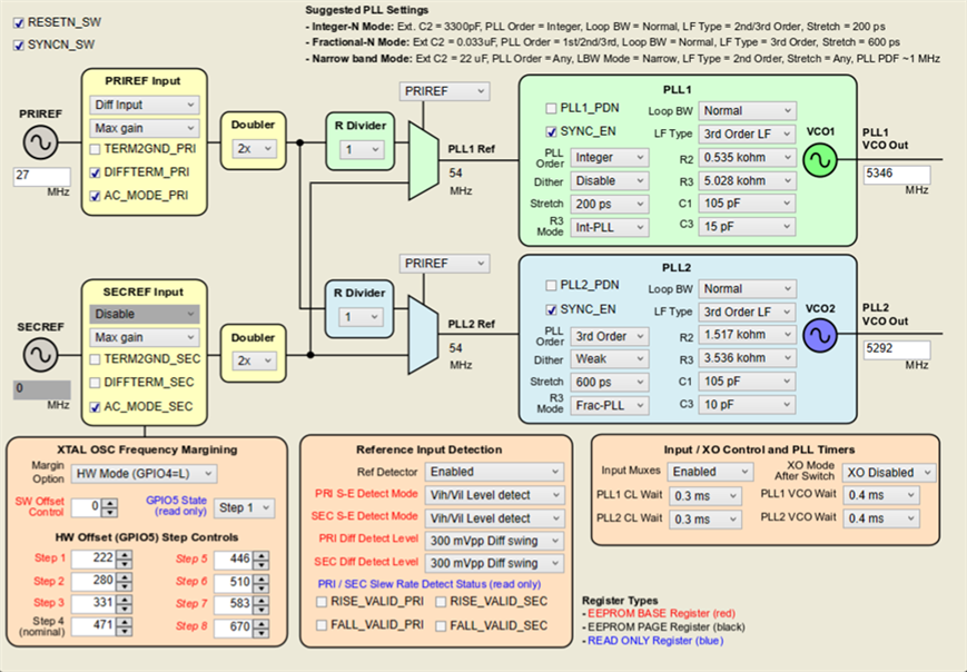

    While reviewing the file named “LMK03328-148p5Input-Updated.tcs”, we noticed a possible discrepancy in the configuration.
    According to the file name and context, we expected the configuration to use a 148.5 MHz input clock. However, when opening the file in TICSPRO1, the PRIREF input is actually set to 27 MHz, with a doubler enabled to generate 54 MHz before reaching PLL1 and PLL2.
    Since the performance evaluation and phase noise behavior can vary significantly depending on the input clock source and frequency, we would like to confirm:
    Was the intention behind this .tcs file to represent a 148.5 MHz input use case? If so, would it be possible to obtain a corrected version of the .tcs file that reflects direct 148.5 MHz input to LMK03328, in line with the test case?
    Also, can you provide the configuration parameter information for the evaluation?
    - LMK03328-148p5Input-Updated.tcs
    - LMK03328-74p25Input-Updated.tcs
    Conor
  • Conor,
    I'm not sure why your capture shows such a different configuration. When I load the .tcs file I get the following:
    These are the configurations I used during testing. I reattached the .tcs files and hex registers here. Please let me know if these also have an issue when loading. Please note that is loading the hex registers, the input frequency will manually need to be changed.
