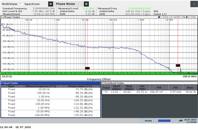

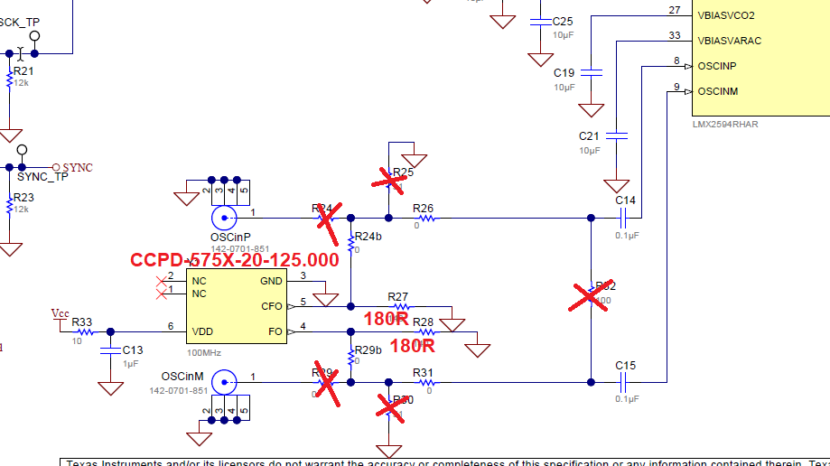

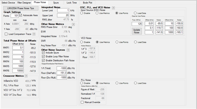

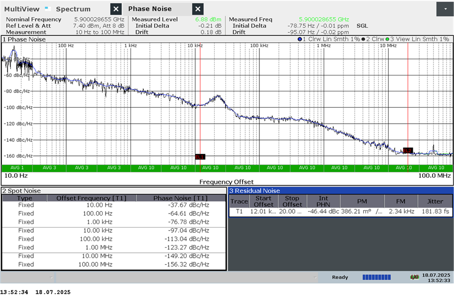

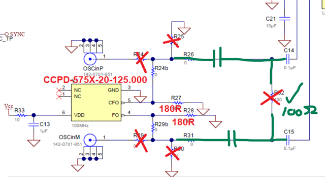

Im using the LMX2594EVM together with a 125MHz referece clock from Crystek (https://www.crystek.com/specification/clock/CCPD-575.pdf). The simulations results with the original EVM loopfilter yield this performance:

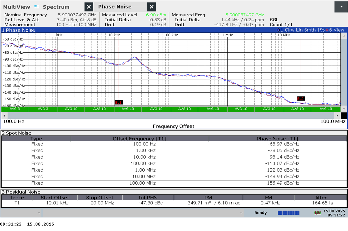

However I do measure this phase noise performance with a FSW with k40 option:
Any hints why the close in phase noise is about 30 dBc worse than the simulation results?
When I use a SMB100B with 125 MHz as reference, the phase noise significnatly improves. So I assume my measurement settings of the FSW are correct.
