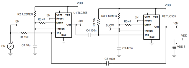

I am designing a PCB for what our company hopes to be a large volume application.   First, I want to test the circuit .  I have a question regarding the TLC556 timer and would appreciate your help as soon as possible so that I can submit my design to the layout team.  I have attached my questions in the pdf called " Desired Function Waveform" . I also attached the TI datasheet that I have been working from.  I am thinking of using a variation of Figure 22 from the attached datasheet, but I am not sure how the timer will start up.  See attached PDF of what I need to build.
  • Hello Robert, welcome to the TI e2e forums.
    In circuit below, EN low stops both timers. When EN goes high, U1 goes high for 20 seconds. U1 going low starts (10min-20s) U2 timer. When U2 is done, it triggers U1 for another 20 second pulse. R5, R6 are optional to slow down (reduce peak current) for the timing cap discharges. Not shown are CONT and supply bypass capacitors. Also add 1N4148 diode from TRIG to VDD (suggested in figure 25 of data sheet). Accuracy will be based on the the performance of the timing capacitors.
    20s every 10min.TSC
    Also consider using a nano power timers such as TPL5110 which do need need large timing capacitors. Start a related thread using that part number to see how that could be done.

    I have now looked at other alternatives and have decided to go with the circuit that you suggested above using the TLC556. I now have two questions regarding your suggested circuit.
    Question 1: You said that in your circuit U1 goes high when the ENABLE signal goes high, which is what I want.  But the data sheet for the TLC556 says that the 556 is triggered by a negative going pulse( ie when the level goes below 1/3 vcc).   Can you please explain?
    Question 2:  The vast majority of the time the 556 will be held in reset.  What is the approximate power consumption (supply current when the TLC556 is held in reset
    Thank you for all your help.
    Robert
  • Robert,
    You will need two TPL5110. Perhaps plus some logic help that can be low power at DC. One can do 20 seconds one 10 minutes
    A1)  Yes it is you say. RESET is high and TRIG is LOW for a short time.
    A2) RESET is output low it is not a shutdown state. No power savings. TLC566 is not the solution you need.

    2. Regarding your previous suggestion and TLC556 circuit diagram.  I have an idea.  If I connect signal Enable (active high)  to the reset pin of the 556 ( this removes the reset condition when ENABLE goes high) and also connect the invert of ENABLE through an RC to the trigger input so than the trigger input goes low slightly after RESET goes high, I think the TIC556 circuit will work.
