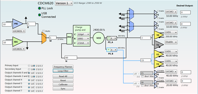

We used the CDCM6208 on our board, locked to a 10M source, outputting 40M.
We are currently facing a problem. In some cases, the phase noise of the clock source is not very clean. There is significant noise at 10K. We would like to reduce the bandwidth from 140K to a smaller value. We have tried many parameters ourselves, but the results are not good. Could you help us take a look and suggest a configuration?

    Please   refer to the document. this is our test  data, thanks

    From bench testing with your configuration, I found that the 10kHz offset cannot be optimized much further using the registers. That said, altering the external loop filter values was able to change this drastically.
    I have two questions:
    1. Can you confirm the external loop filter values being used on your board?
    2. From my bench testing, I found that I was able to reduce the noise at the 10kHz offset, but at the expense of the overall jitter value. Which is valued more? I can still provide several options and captures for each, but I would like to better understand the priority here.

    1,our C1=470P,R2=560,C2=100n
    2,We can modify the resistors and capacitors around the CDCM6208.
    3,If possible, please provide a compromise solution between the overall noise level and the 10 kHz noise peak. We can modify registers or adjust the resistors and capacitors on the board.
