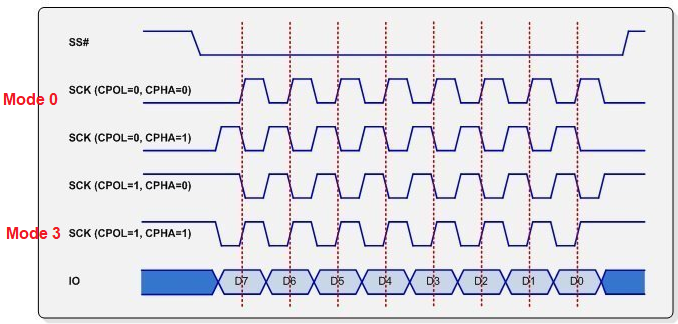

I would like to know the following details for the SPI interface in microwire of LMX2571.
  1. clock frequency
  2. clock polarity
  3. clock phase
Thanks & Regards,
Athira K
  • Hi Athira,
    The device supports mode 0 and mode 3.
    SPI speed is available in the datasheet.

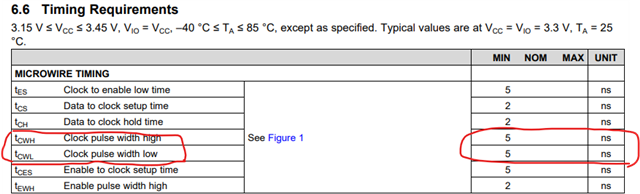

  • Dear Noel,
    from the above image it shows like Tcwh and Tcwl are 5ns.
    SPI CLOCK FREQUENCY = 1 / Tcwh+ Tcwl
    SPI CLOCK FREQUENCY = 1 / 5ns + 5ns
     SPI CLOCK FREQUENCY = 100Mhz. can u please confirm is this clock frequency Right. Because 100Mhz is very huge frequency so we want to confirm this.? Also can we reduce this frequency?
    Thanks & Regards
    Athira K
  • Hi Athira,
    Right, max. is 100MHz.
    As long as SPI clock is not higher than 100MHz, it will work.
