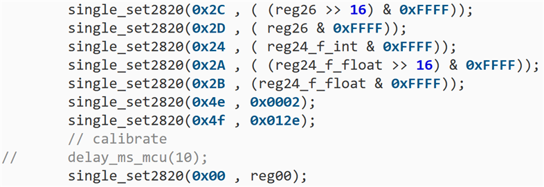

We’ve encountered a similar issue while continuously sweeping the output frequency from 13 GHz to 20 GHz in 100 MHz steps, with a dwell time of 500 ms per step. Around the 400th iteration, the device consistently loses lock.
When this happens, toggling the RESET pin and reinitializing the device restores normal operation. However, we’re looking for a more robust solution to prevent this lock loss altogether.
Has anyone found a way to mitigate this behavior during high-frequency sweeping?
Thanks in advance!
Here’s the register sequence we’re using for each frequency update:

  • Hi Yingju,
    There is a small percentage that VCO doubler calibration may fail and when failure happen, we have to reset the device and start over again.
    If your application requires changing the output frequency from time to time, you can either operate the device in full assist mode or use InstCal, both approaches skip calibration and therefore avoid losing lock due to VCO doubler calibration.
    InstCal is more easy to use, in my opinion. To use InstCal, we will do a one-time calibration. After that, changing frequency does not require calibration anymore, simply program the frequency related registers and the device will lock to the desired frequency.
    In addition to the frequency related registers, full assist mode requires programming a few additional VCO and VCO doubler related registers. A one-time calibration for each desired frequency is required to gather the VCO can VCO doubler register information. More on full assist is available here: https://www.ti.com/lit/pdf/snaa336
    Let me know how you would like to proceed, I could provide more instruction on the operation.
