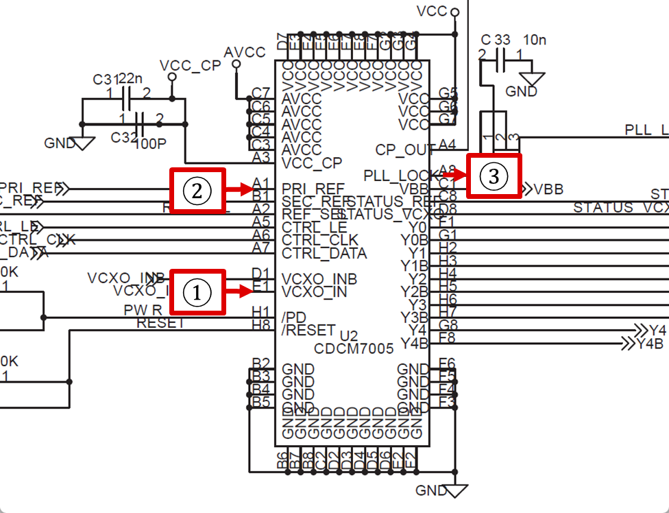

Our customer has some application question how CDCM7005 works.
Q-1 : In case (2) PRI_REF is not locked while (1) VCXO_IN clock comes in, (3) PLL_LOCK output High level ?
Q-2 :  While the customer swich over PRI_REF clock to other clock by via external circuitry, doe he need to input reset signal via REST/HOLD pin ?
Q-3 : unless he reset in above Q-2, does PLL_LOCK go to High ouput ?

  • Hi Sandra,
    The customer issue is PLL_LOCK=High even though PRI_REF clock is unlocked against VCXO_IN clock. So I think this is the condition that clocks are outside of lock detect window in PFD.
    This is why we are asked if we can see the other PLL_LOCK=High condition.

  • Imi-san,
    Can you share with me customer schematic over the email thread?
    Can you also share the state of the /HOLD pin and its programming? This may cause similar issues as to what you're describing, check figure 21 of the datasheet
