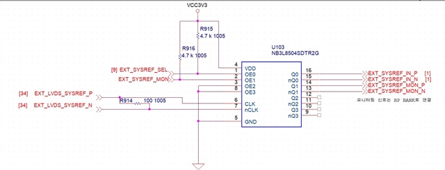

I am designing a clock tree using the LMK04828 and have a question regarding the CLKin input requirements (used for JESD204B SYSREF) when the driving source is temporarily disabled.
[System Setup]
I am driving the LMK04828 CLKin0 port with an external LVDS fanout buffer (NB3L8504S).
The signal is DC-coupled with a 100-ohm differential termination resistor placed close to the LMK04828 input pins.
The buffer has an Output Enable (OE) pin. When the OE pin is pulled LOW, the LVDS outputs go into a High-Impedance (High-Z) state.

  • Hi There,
    CLKin0 pins has internal bias but there is no offset voltage between them. So if the input pins are physically left floating, chattering may happen. When your LVDS driver output is Hi-z, CLKin0 is still connected to the 100Ω resistor and the output of the LVDS driver. With this configuration, it is hard to tell if chattering would happen. In fact, even if your LVDS driver is enabled but the output is static (logic 0 or logic 1), the situation is same as if the LVDS driver is Hi-Z because the AC-coupling capacitors have blocked the DC from the driver.
    Suggest change CLKin0 type to MOS, there will be an offset voltage between the pins to prevent chattering.

    The signal we are feeding into CLKin0 is a JESD204B SYSREF. Specifically, we are using an LVDS fanout buffer (NB3L8504S) to drive this signal. We will control the buffer's OE (Output Enable) pin to send discrete bursts of exactly 2 pulses, after which the OE pin will be disabled, immediately putting the driver output into a High-Z state.
    Because this is a pulsed signal with long idle periods (unlike a continuous high-frequency clock), using AC-coupling capacitors could cause DC wander or block the SYSREF pulses entirely. Therefore, we must use DC coupling (a direct connection without AC capacitors) between the NB3L8504S outputs and the CLKin0 pins.

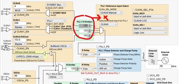

  • As previously discussed in a related thread (see second attachment), we are driving CLKin0 with an LVDS fanout buffer (NB3L8504S). To meet JESD204B requirements, we send discrete bursts of exactly 2 pulses by toggling the buffer's Output Enable (OE) pin. When idle, the driver enters a High-Z state.
    MOS Mode Confirmation: The previous advice suggested using MOS mode for CLKin0 to utilize higher hysteresis and prevent chattering during the High-Z state.
    In my current TICS Pro configuration I have set CLKin0 to 4 MHz and intended to use it as the reference for SYSREF MUX. However, the PLL1 R Dividers for the CLKin0 path are currently greyed out (inactive) and I am unable to configure the LOS (Loss of Signal) settings for CLKin0 in the "PLL1 Reference Input Select" block.
    LOS functionality only applies to the PLL input path. If the CLKin0 signal is routed to the SYSREF Mux, LOS functionality cannot be applied to that input.
    Michael
