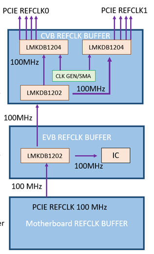

Hi experts,
Regarding the PCIe Gen6 RefClk: will it still function properly if it passes through 3 or 4 CLK buffers? Customer is considering LMKDB1204 and LMKDB1202. How should we estimate or evaluate the cumulative impact of cascading these buffers? Note that the specifications for the first buffer are currently unknown, as it depends on the specific motherboard design.
BR,
Allan
