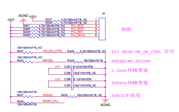

        I use my own hardware board.My design has reserved the SPI interface of LMK05318, as shown in the following screenshot. I am using USB2ANY to connect LMK05318 through the SPI interface.but I don't know how to program the internal EEPROM.Could you please guide me on how to program the internal EEPROM of LMK05318 using USB2ANY?
  • Hi Chen,
    If you've already connected a USB2ANY to your hardware, the most straightforward approach is to program the EEPROM directly in the TICS Pro GUI. On the "EEPROM" page in the GUI, you can click on "Program EEPROM" to write the config loaded in the GUI to the device EEPROM. I've attached a screenshot of the relevant page in the GUI for reference. To verify that the EEPROM was successfully programmed, you can power cycle the device and readback the EEPROM status, you should see the value for NVMCNT increment by one. Let me know if you run into any issues getting this working on your end.

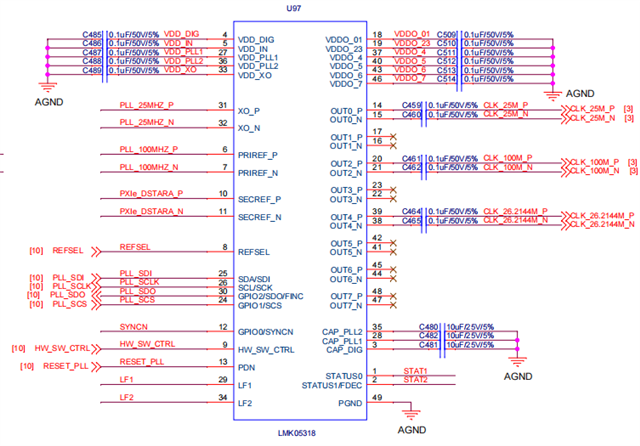

           Currently, there are no two-channel reference clock inputs for DPLL on my board.Only a 25M crystal input signal is available.I only want to use the APLL mode.The complete circuit is shown in the following screenshot.
  • Hi Chen,
    Thanks for confirming that only the APLL is being used here. I looked through the .tcs config again and I did notice a few things which could prevent the APLLs from locking properly, which could be keeping the outputs muted. I made the following changes to the config:

  • Hi Connor,
         Thank you for sending me the PLL configuration file.I am using your configuration file to program the PLL.
          At the same time, I also identified the root cause of the problem.This should be caused by the "PDN" pin.In my design, no capacitors were added to the "PDN" pins to form a capacitive-resistive reset circuit.Therefore, the PLL remained in the reset state, which led to the failure of the EEPROM programming.
         The problem has already been settled.
         Thank you for your help. Wish you all the best in your work.
  • Hi Chen,
    Thanks for the update here. I'm actually surprised that the issue was with the PDN pin since there's a 10k pullup resistor populated, so this pin should have been pulled high to bring the device out of reset. But if this net was connected to some other source that was pulling it low (ex: GPIO from your host FPGA / microcontroller) then that would explain the issues you were seeing with programming the device.
