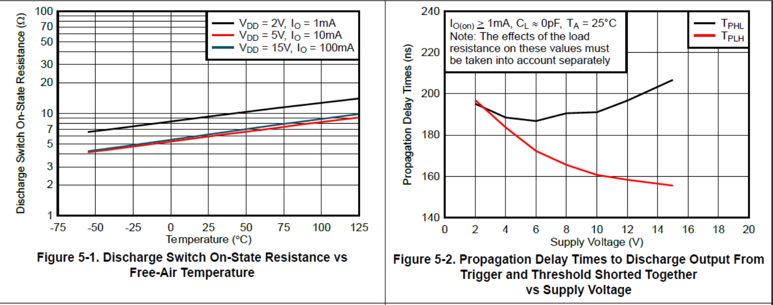

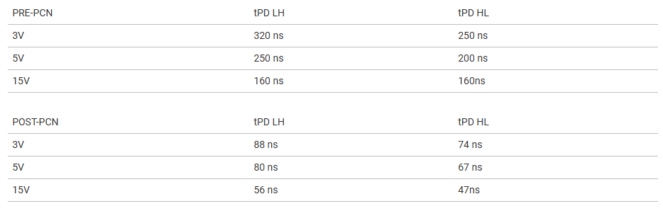

It seems that the propagation delay time is controlled very small in the products of the new process, but there seems to be a big gap with the data of propagation delay time in the data sheet.
Is the measurement condition different?
Or is the data in the data sheet wrong?

  • Hello DH,
    That PCN did result in delay being much shorter as described in FAQ.  A later PCN 20260217004 changes design to make delays closer to original. The current data sheet is updated for this new PCN.

    Is the Rev in the datasheet I->J because the die was changed to Rev. A in the first PCN?
    I did not see any data on the Rev. J datasheet showing a significant reduction in delay time.
    I am asking because the frequency and duty are set in a wide range, which has a significant impact on the system we are currently using.

  • DH,
    The importance of propagation delay being the same wasn't fully understood when rev was changed to A.
    Shorter delays are better except when existing application designs were tuned for original being worse.
