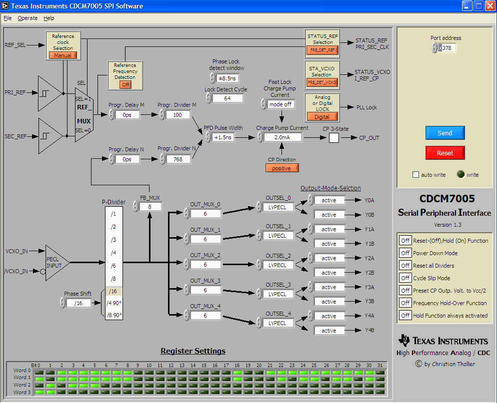

    3) In the following screen shot, you can find the divider value you need to set into the device
    I tried that "Texas Instruments CDCM7005 SPI Software".  How the divider values for the M divider =100, N divider =768, P-divider=16 were acheived by the software (Where we have give the Ref_Clk frequency and the desired Output_Clock as input in the software to calculate the divider values.  How do I find the required VCXO frequency for 102.4MHz output clock)

    the current available version of the GUI does not include a frequency planner tool. The VCXO possibilities for a defined output frequency (i.e. fout=102.4MHz) are given by multiplying fout x1, x2, x3, x4, x6, x8, x16. In your case I wanted to suggest you a VCXO frequency of 614.4MHz (which is 102.4M x 6).
    The next step would be to calculate the M, P and N values. How to do this? You should define the PFD frequency, which is given by the greatest common divisor between the selected VCXO frequency and the input reference frequency (i.e. 10MHz), which you can get within the available M, P and N value range. In your case the greatest common divisor is 100kHz. In case you have multiple choices I would suggest you to pick up always the highest possible PFD frequency.
    Based on the calculated PFD frequency, you can derive the values of M, P and N dividers.
